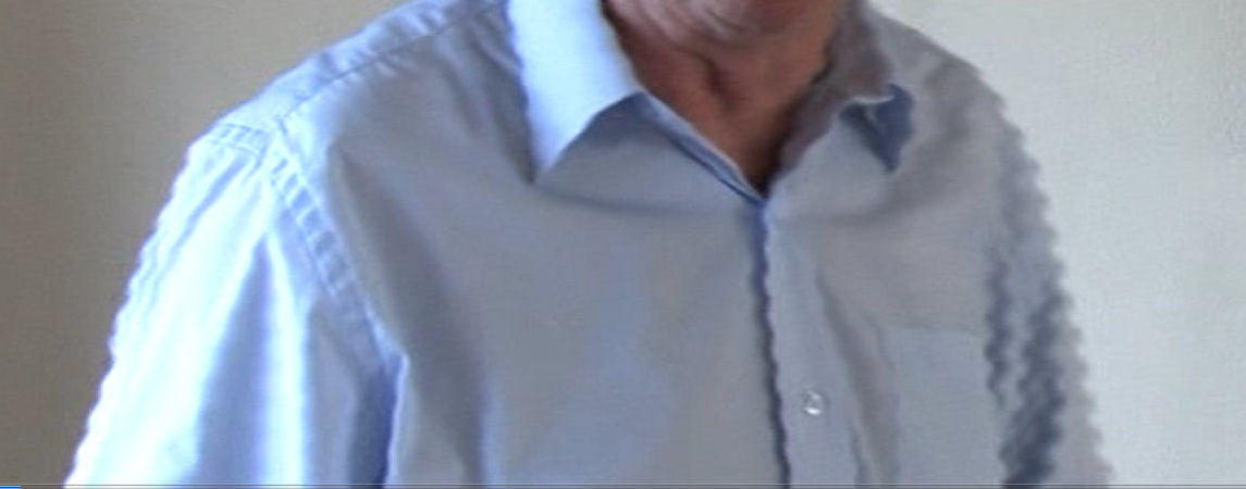

The image though not sure if it is what you have suggested (or as I described) as I did view it on TV. The picture file shows what I mean

Whoooo! Are you doing magnetic field experiements? Did that guy disappear into thin air? :)
Looks like you've got some bad deinterlacing going on right there..

All you have done is brought in 1080i footage into Vegas and then downscaled it to 720x576. When Vegas does the downscale it also totally messes up the interlacing lines so that's why your video has all the weird and wonderful bumps and lumps. Bet it looks weird on the TV as well!!! Your HD footage is interlaced Upper Field first and you are now rendering to SD which is Lower Field first and also resizing it!!
As Perrone says the footage needs to have the interlacing removed BEFORE you edit!! In Vegas all you need to do in project properties is change the "de-interlacing" box from none to interpolate and also set render to "best" .... edit and render and you will find all is OK!!
