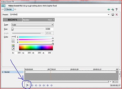

I'm using Sony Vegas Pro v9.0c Build 896. The track motion is sized for PIP. I have pics on track with "Maintain Aspect Ratio" for each pic check. I've applied a border to the track.
The problem is that the pics PIP are in the aspect ration of 4:3, but the border is not as it is 16:9. The Preview windows shows the border as 4:3, but when I render it is at 16:9.
Perhaps it has something to do with the track properties, but it appears that you can only set the default values, that do not include the aspect ratio.
See attachment for a visual of the issue.

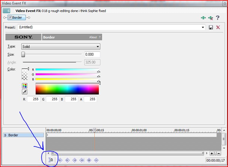

Open the FX go tow the bottom where the FX timeline is, on the left there is an arrow, click on it. Problem solved.

The Track FX Border effect arrow in the time line was pointing to the left with a 16:9 screen border on the 4:3 PIP. If I click it, then it points to the right and puts a border around the enter project (BorderAroundEntireProject.wmv).

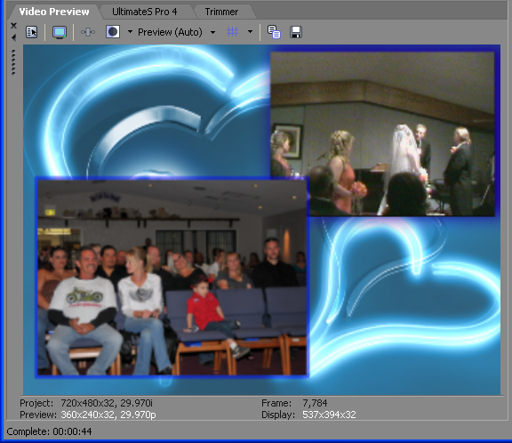

PreviewWindowShowingDesiredEffect.bmp is this effect that I'm trying to accomplish.
Please see attached screen shots.
Ken

Ken,
Sorry, I misread the original post. Gotta get the eyes checked.
I know it's a PITA but how about taking the BorderFX and applying it to the CLIPS (Events) instead of the track.

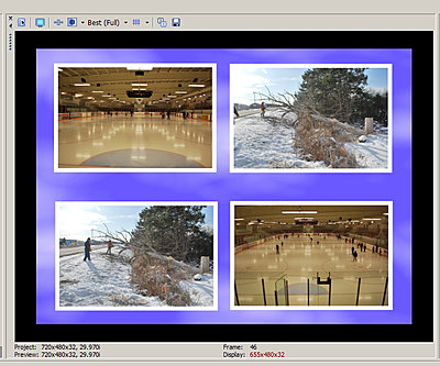

Ken, I just dropped the 4 images shown here on the timeline, went into Pan/Crop and choose the first location (top right), applied a white border at 0.05, clicked the Pre/Post Toggle arrow, copied this FX and then pasted it simultaneously to the other 3.
All I had to do was reposition them and the border stayed exactly the same width.

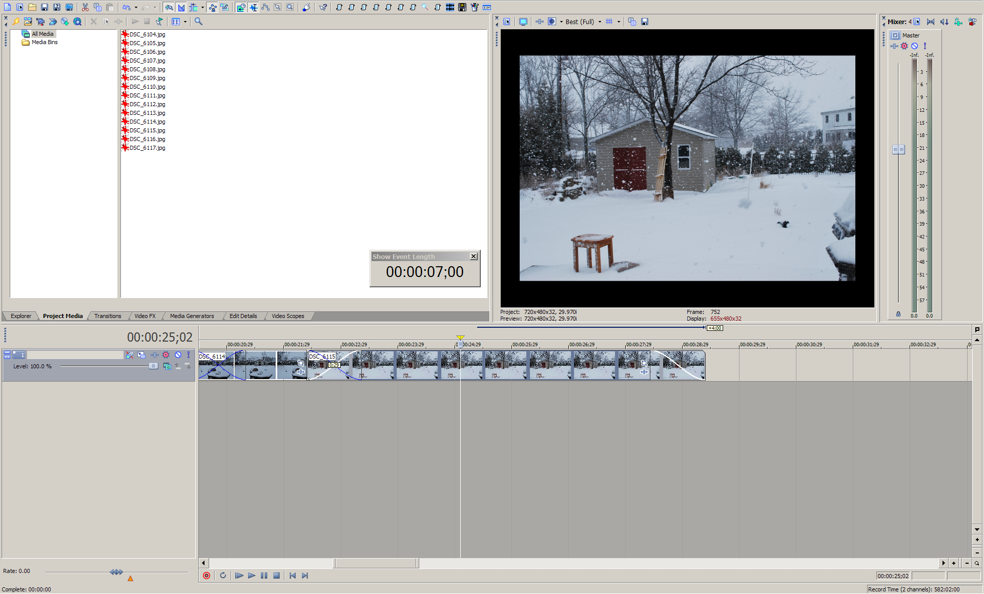

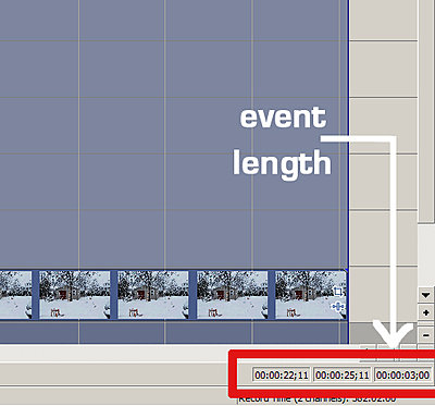

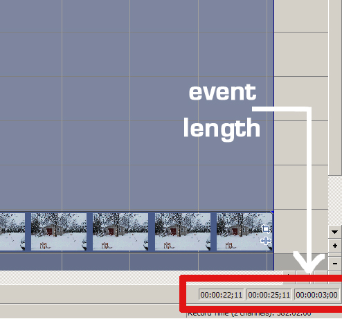

Double-click an event to highlight it and look in the box in the bottom right-hand corner for its length.

Just an aside to Mike's comment, you can also use the same technique to check the duration of an empty space between events on the same track. Double-click in the space between two events on the same track and that space will be highlighted, with the locations of the start and end as well as the duration of the gap shown in the same windows as Mike's graphic.

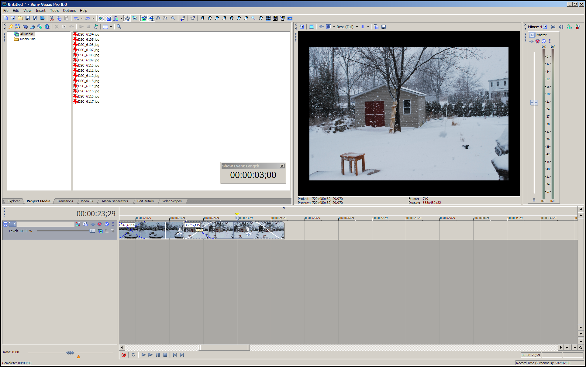

But it sure would be handy to hover over it to see things like the events length and file name.
View - Active Take Information (Ctrl+Shift+I) will give you the event name.
Also if I drag the event longer or shorter it should show me the length in real time.
As you can see in the images below, the "Show Event Length" script on the page you linked to will do this for you.
This script comes close, although it would be nice if I could just dock it somewhere.
Make it a tool bar icon, run it and place it anywhere you want.
It stays on top of the other tabs and, as you can see, it's very small so there's no need to dock it.
