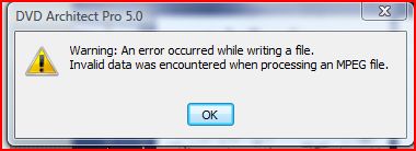

I've tried to render a project to DVD 4 times now, and i keep getting the following message:
Warning: An error occurred while writing a file.
Invalid data was encountered when processing an MPEG file

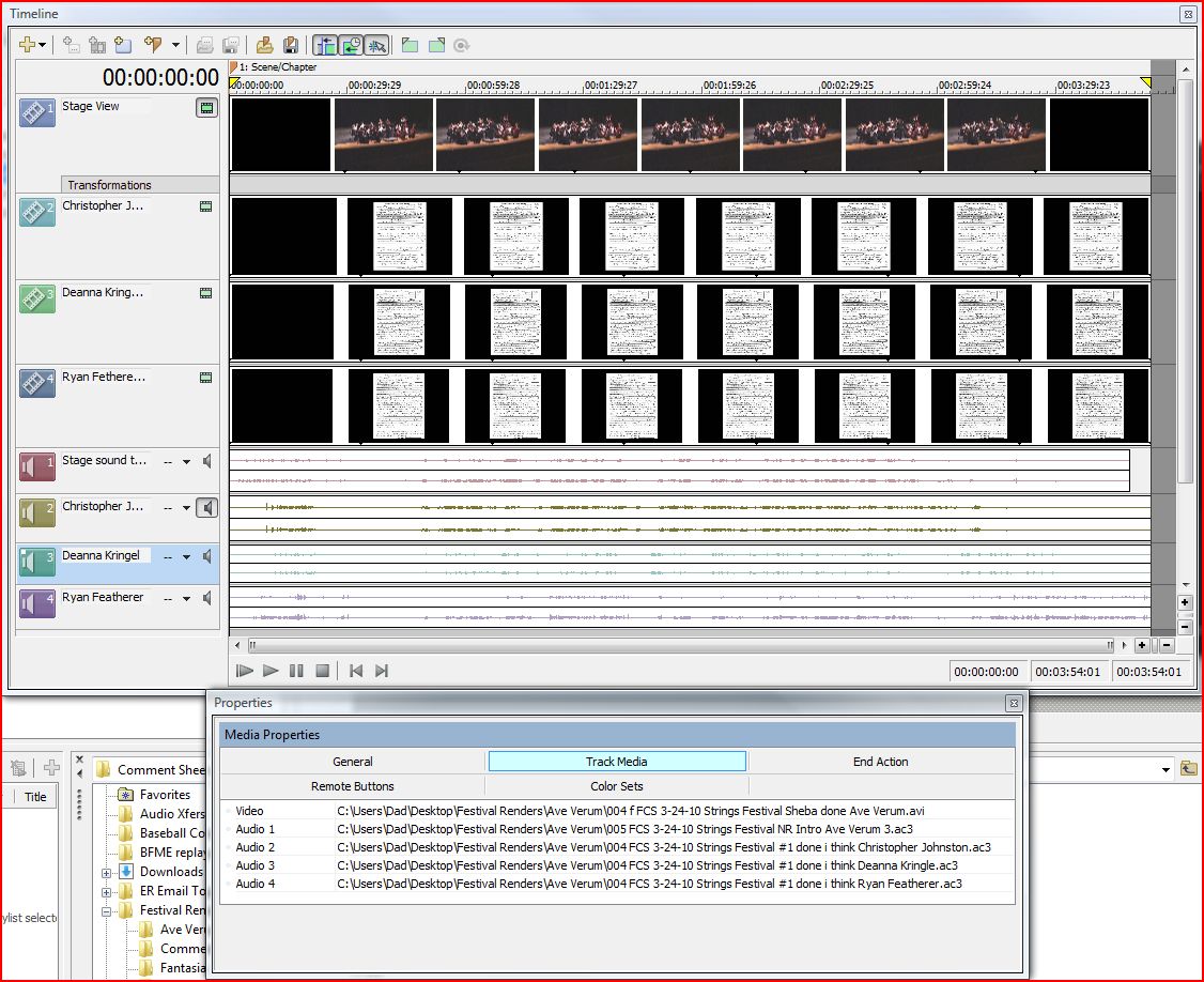

It's a project with 3 individual video elements, each accessible from the main menu, and each with end action leading to the next element, and then at the end of the third element, end action back to the menu.
Each elelment has 1 main audio and video track, and 3 alternate "angles" and 3 alternate audio tracks.
It appears to go through the rendering process successfully, but seems to hang up in the DVD file creation process.
On the 4th try, the alternate video traks were imported avi's as the help files recommended.
The alternate audio traks are ac3's.
The menu backdrop was an mpeg2 without audio. (originally it was an mv2, and i didn't know if that was creating the error).
I allowed all default recompressions, etc. to occur in the optimization phase of seting up the creation.

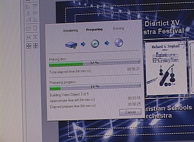

I found this entry at the sony forums, but it didn't seem to lead to an answer:
Sony Creative Software - Forums - DVD Architect Software Messages
It failed at the point of preparation of the 3rd of 5 video objects, for whatever it's worth.
Thanks for your consideration.

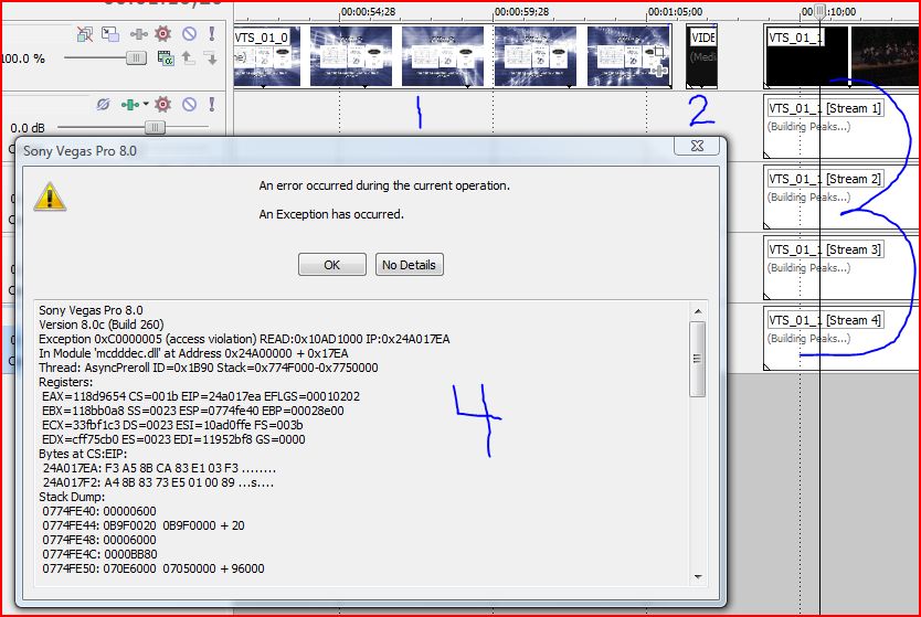

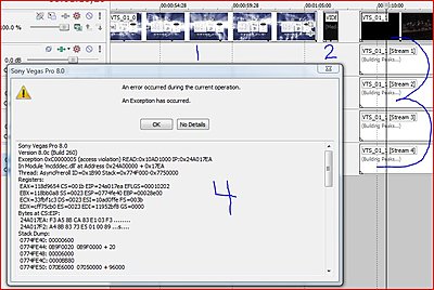

well... in case this means something to someone...
I went into the files created by the failed process...
i dropped the vob files onto the vegas timeline to see what there was...
looking at the attched screen shot...
#1 is VTS_01_0.VOB = 26,618KB = my menu, seems ok
#2 is VIDEO_TS.VOB = 232KB = 00:37;26 long "empty, black" video on the vegas timeline
#3 is my first video element, which showed up on the timeline when dropped as the primary video from the 1st video element (no signs of the 3 alternate angles) and 4 attached audio tracks.
Right after dropping this element onto the timeline, it triggered an exception error from Vegas, which leads to the program shutting down when you click "ok".
So...
the menu seems to be ok as is, without regard to it's imported backdrop file having been rendered from Vegas as interlaced.
and
as indicated by the last notice before the error message from DVDA while compiling, the error seems to be in the multi angled file, apparently the 3rd of 5 objects (4th and 5th objects probably would have been my 2nd and 3rd video elements with their alt audio and video traks).
Thanks for your continued consideration.
