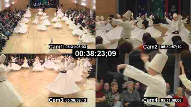

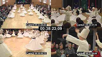

Um, right, that's a common application - didn't realize you were prepping review reels. The method above takes you as far as show reels.
As Edward says above, go through the steps, then drop the Sony Timecode effect - could be on the track.
The TC effect displays different code when applied in different places, and Vegas gives you choices!
Project, Bus, Track = Timeline Code (project code)
Event = starts at 0:00 for each event that it is on.
Media = original camera timecode
See the attached photo for an example of using master and media TC in a review copy of a multicam shoot. The big TC in the center is project, the smaller windows are camera TC.
These tricks make Vegas quite a versatile generator of TC window dubs...
