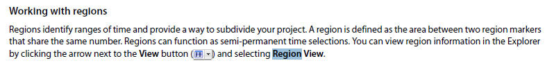

From page 127 of the Vegas Pro 9 manual:

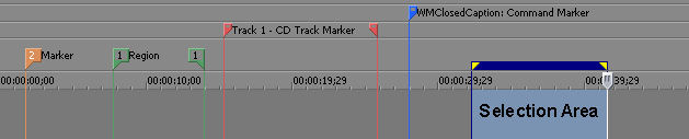

Standard Markers - "M" - show up as orange.
Standard Regions - "R" - show up as green.
CD Regions "N" - show up as red
Command Markers - "C" - show up as blue
These are the standard colors unless you've changed them in the preferences.
Simply dragging the cursor across the timeline creates a "selection area"

Excellent illustration! It gives me even more information than I was yet aware to ask and takes me a lot further on down the road. Thank you.
