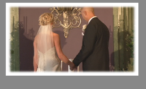

Use the cookie cutter fx., unless your older version doesn't have it. Start with the square preset, change to a rectangle, and adjust as needed; you can size/feather the border to your heart's desire.

6 does have the Cookie Cutter and yep, I forgot about that. Thanks for the reminder Jeff.

As you'll see you can make the border any color you choose; cookie cutter is a very flexible tool.
