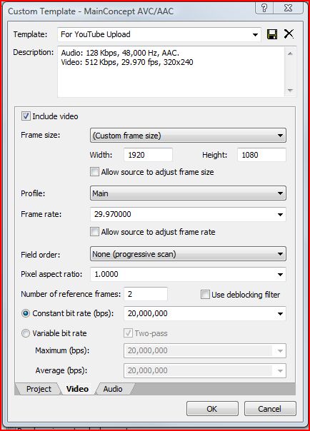

Just a note to add to Don's answer. Going from an HD source to an SD file using the encoder in Vegas will lead to less than a stellar looking DVD. This is mostly due to the scaling algorithm that Vegas uses when converting your 1080 content to a 720x480 video. There have been posts here on how to get a better end product. Here is one thread that discusses it:
http://www.dvinfo.net/forum/what-hap...d-quality.html
By using Virtual Dub or VDub you can get a much better quality picture. The downside is time. Depending on your computer it will add a lot of time but for me the improvement in end quality is very much worth it.
For your YouTube Vimeo upload question, both of those sights like MP4 or H.264 files. From my experience they pretty much destroy WMV when they process them for posting. I attached a template I use for uploading to YouTube. Your project setting for Vegas should match whatever the majority of your source files are. Since your using a Canon XH A1 it should be 1440-x1080. Since you have 60i material you'll also have to remember to convert to 30p (or really 29.97p) for web upload or you'll see really bad banding in high motion scenes. For most video I shoot progressive so either 30p or 24p. That just makes it easier for web upload and I personally like the look in general. But there are situations when 60i is preferred. You're camera just doesn't shoot square pixels so but it is HD. the 1440 pixels wide is just the HDV standard.
Hope that helps,
Garrett

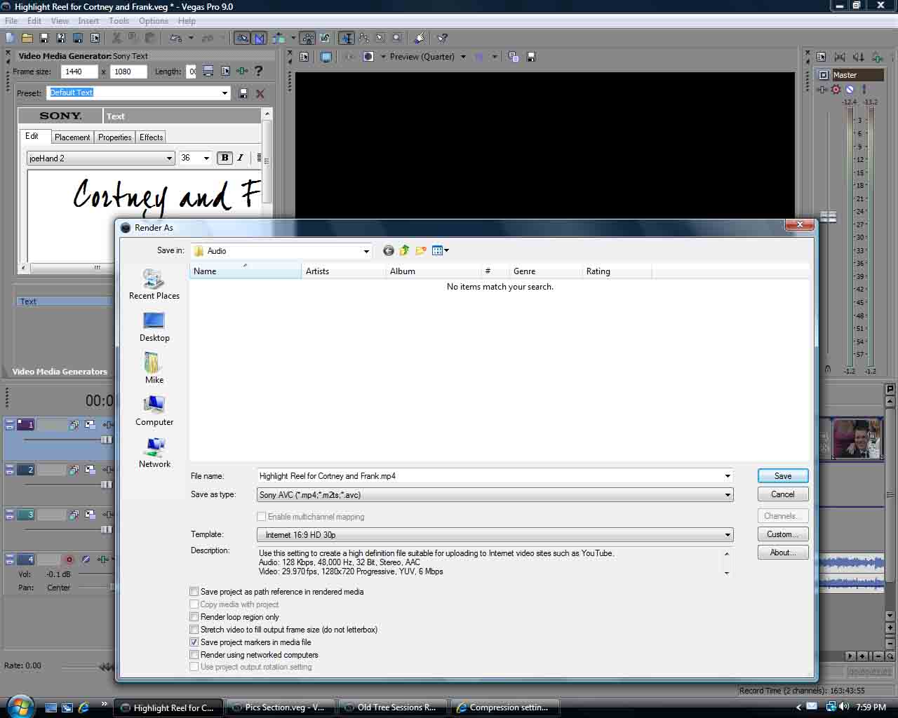

Hi Gregory,
To answer the last part of your question about uploading to Vimeo & You Tube, I use the Sony AVC MP4 setting with the HD 30F template. It looks great and is made for web play.
Here is a sample of one of my vids:
-Mike

Old July 17th, 2010, 05:54 PM   #8
Join Date: Jul 2007
Location: Novato, CA
Posts: 1,774
Hi Mike,
I've only played with the Sony MP4 render engine for some Blu-ray burns. Never for web uploads. I noticed in your clip at around 26 seconds there's some noticeable macro-blocking in the mountain areas. Is this something Vimeo is doing? Also, could you post a screen shot of your setitngs you're using?
Garrett
Old July 17th, 2010, 06:01 PM   #9
Join Date: Feb 2010
Location: West Orange, NJ, U.S.
Posts: 163
Hi Garrett,
Here you go.
These settings aren't perfect, but I use them for wedding highlight reels as well and they turn out pretty good.
Vegas renders this template pretty quick so that's a big plus for me.
