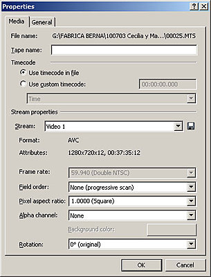

Where can I apply the undersample rating in the footage properties? I don't see the option and the frame rate field is fixed.

I have confirmed that the same happens for me and there is no option at the media level. If you wanted to do it "after the fact", a script could do them all for you in one pass. But, indeed, it reverts back to one after a split.

Thanks Edward, yes, I think the only option available is via scripts or plugins because I haven't found any option in vegas that stops the undersample reverting to 1 after each split.
