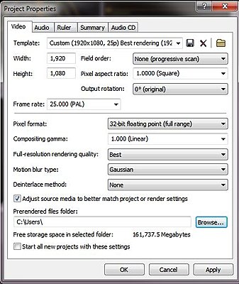

Hi Larry. I'm about to go through some testing, but a question came up which I never thought to ask before.
What should the Project Settings be when working with either 1080 50p AVCHD footage? I can't find a template for that format in the pull-down menu. Or must I enter the settings manually? If so, which settings are recommended?

Shalom Adi,
I’m not Larry but I can help you selecting the Project Settings for working with 1080 50p AVCHD video.
Please observe the following screenshot.
If you have any questions regarding those settings I can be of assistance further.
I need some starting tips for working with Panasonic HDC-TM700 and Vegas-capture.jpg

Mr. Bolotin - is there a reason why you are using 25p instead of 50p?

Larry,
If you are asking why I use 1080p25 (i.e. 1,080 lines of vertical resolution by 1,920 pixels of horizontal resolution 25 progressive frames per second) video mode instead of 1080p50 mode, my answer is this.
In Europe, 1080p25 signals are the only ones that have been supported by the DVB Full HD suite of broadcasting standards. Even though 1080p50 has been foreseen as a future-proof production format, and eventually a future-broadcasting format, commercially available TV sets capable of showing 1080p50 are still nonexistent.
In the United States, all major networks use either 720p60 or 1080i60 encoded with MPEG-2. Satellite service though has many channels that utilize the 1080p/24-30 format (Direc TV, XstreamHD, Dish Network, to name a few).
Regarding video acquisition, as of year 2010, majority of consumer camcorders and professional video and DSLR photo cameras can capture 1080p24, 1080p25 or 1080p30 signal. Only Panasonic offers a few consumer cameras that can capture 1080p50 and 1080p60 picture.
Obviously, among high-end professional digital cameras the range is better: Sony CineAlta F23, Sony SRW9000, as well as RED One cameras are all that capable of capturing 1080p50/1080p60 pictures.
