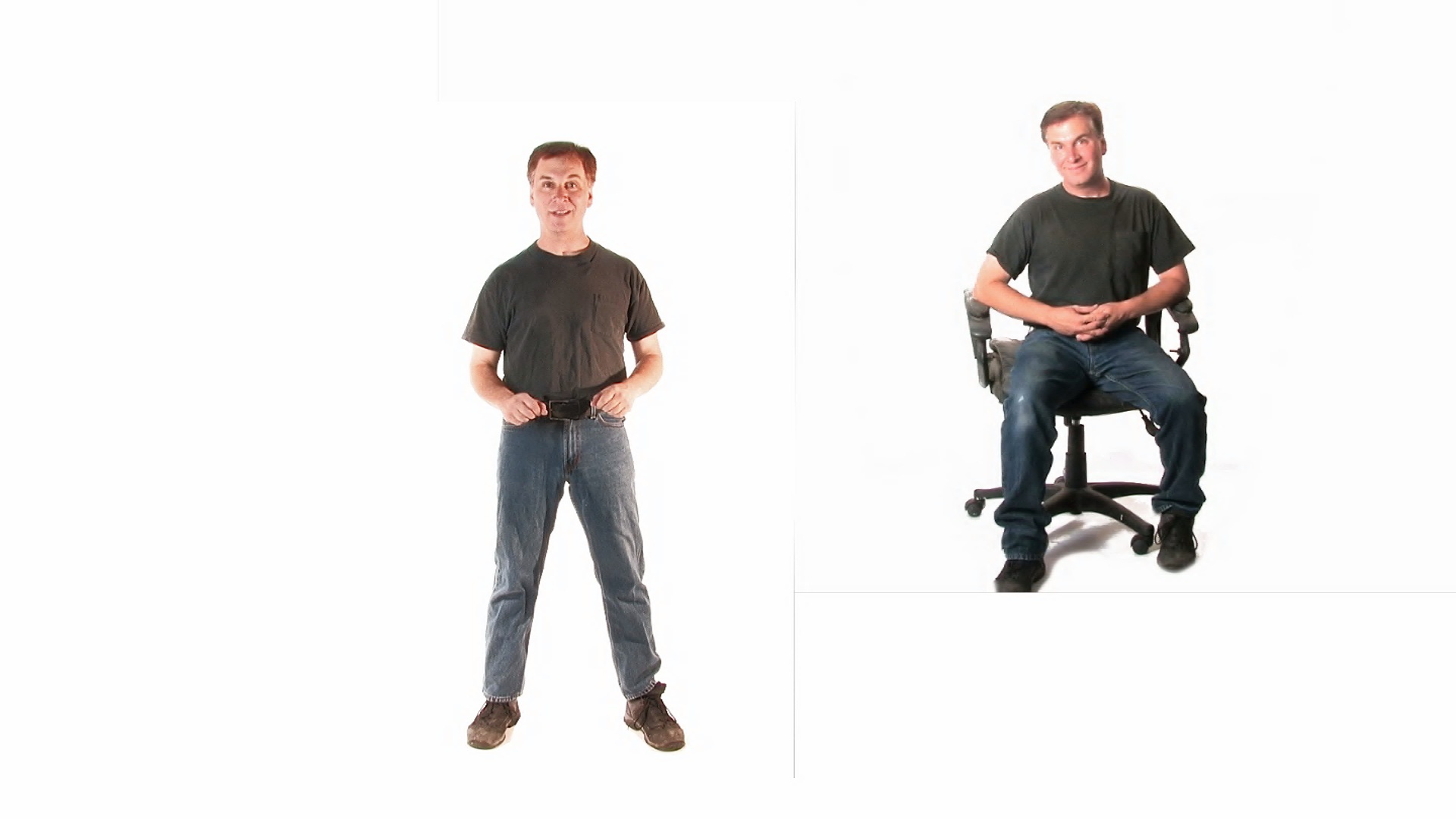

I've been doing videos with a white screen background, and placing in multiple instances of people.
I get a slight gray border line around frames placed within the larger frame.
I'll attach a snap shot of what I mean...
In the past, I would painstakingly mask these borders out, but I've "heard" there is a setting somewhere that gets rid of them. Does anyone know of this?

Don't know Vegas but since the lines are straight can't you just crop or do they stay even after the crop? Also looks like the guy on the right is framed too close as his foot is cut off so cropping would just make it worse.
Other thought is do do a key. Instead of blue or green just specify white.

Can't crop unfortunately...
Thanks for the input. Unfortunately, when I crop each picture, I just get a new border around the newly cropped image. This is made worse by the fact that I'm panning between characters in post, so the borders are moving all over, and that makes it nearly impossible to mask them out etc.

Have u tried putting a border with feather edges on the image? The guy with the leg cut off would be an issue thou.

I think I'd try using the Pan/Crop masking feature.

I'm trying to understand where they might come from.
One thing that struck me, you mentioned that re-cropping simply yields a newly placed grey line? These are multiple videos, shot on a white screen that don't show these lines at all when viewed individually? You're compositing them against a white background media?
I've tried what you've done, with video and stills and had no such problems.
It almost sounds like this is a teeny-tiny 2D shadow or glow peeking through in the background.

Problem Solved!
Hey! Thanks everyone!!!!
The problem had an ODD, but complete solution, so I wanted to mention it here in case any of you run into it in Vegas...
When you select any video event FX, you'll notice at the bottom of the box that pops up for that FX there is a little arrow next to the name of the FX. This is the "pre/post" toggle arrow.
All you have to do to get rid of these annoying borders is toggle that arrow for each FX you have loaded.
I assume that why Vegas does this is to allow you to visualize the borders of different video clips layed in for positioning purposes.
It would have been MUCH smarter to have the borders appear when working on the project, but not have them appear in the final render as you'd never want that regardless.

Thanks for telling us the ultimate solution. The Pre/Post toggle flag determines whether the effect is applied to the image BEFORE it does the pan/crop or AFTER it does the pan/crop. It's not an overly well-known feature but is very important.
