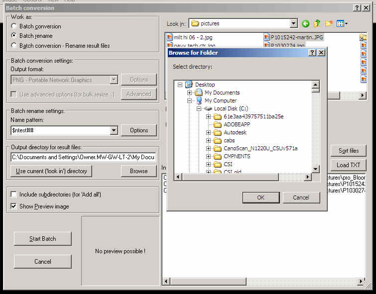

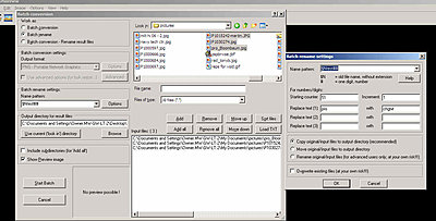

All right, I will do my best and hope this helps!
Going over what you've written, it all looks good - perhaps a missing step or two, or maybe you did them and didn't write them down.
You do need a hash mark (#) for every digit in the output file name. You'll see that in the name_setup.jpg below in the top field, which reads $Ntest##.
You do need to specify an output folder, you'll see that in output_setup.jpg.

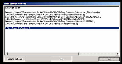

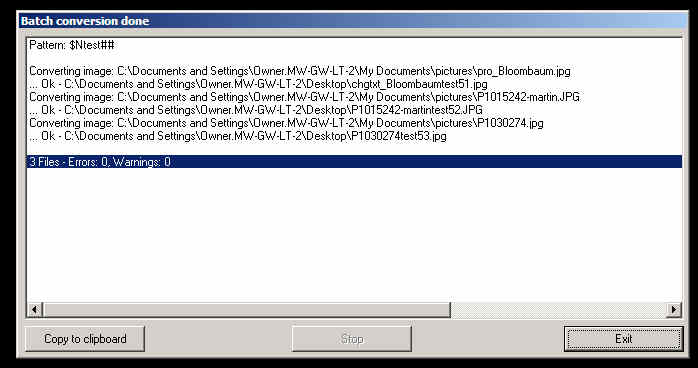

When you click "start batch", it should result in the log display that you'll see in result.jpg.
I just did it, and it worked - I have the 3 new images, with sequenced numbers sitting on my desktop, as noted in the result.jpg.
Is it possible that the new images went to some default output folder? To copy them back to the same folder, you'd select "Use current look-in folder" in the Batch output settings field.
Bunching Time lapse clips-name_setup.jpg   Bunching Time lapse clips-output_setup.jpg
