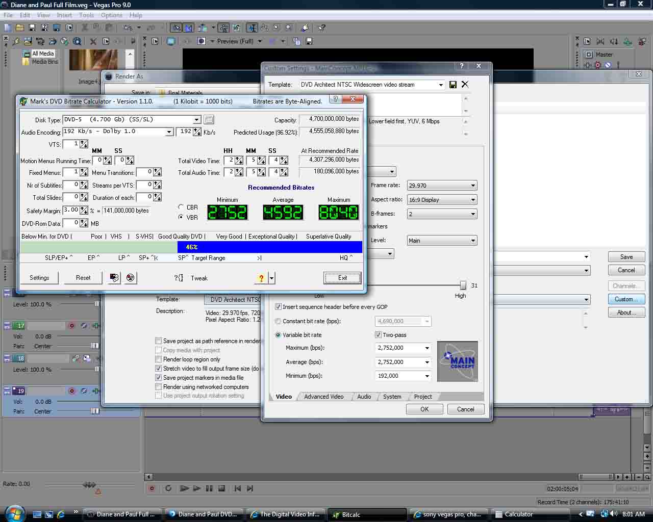

Hi all,
I'm rendering out to DVD NTSC DVDA. I have a film that is 2 hours, 5 minutes, 4 seconds long. I did some research about making sure the file will fit onto a standard DVD and used Mark's Bitrate Calculator to get my settings.
I've gone into Vegas' custom area for this render and tried messing with the Max., Avg., and Min. bitrates. I think I'm doing it correctly but it seems like Vegas won't allow for different values in those boxed. The calculator indicates to use min 2752, avg 4592 and max 8040, and when I choose VBR and put my first value into the minimum bitrate box (2,752,000), and then try to enter the avg rate of 4,592,000, the avg rate for right to 2,752,000.
Can someone tell me what I may be doing wrong?

Here's a screenshot of my settings and the calculator.

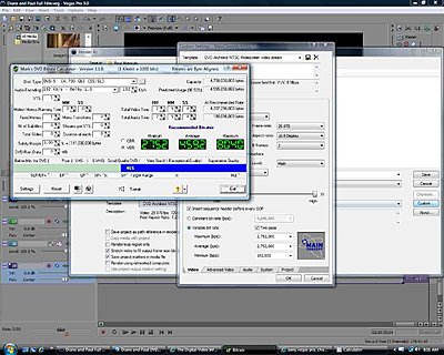

Mike, I just tried it and it worked for me so I don't know why you're having problems.
All I can suggest is try entering the numbers from the top (Max first) down and see if that helps.
Also, can we see the entire Custom screen instead of it being partially obscured by the bitrate calculator?

Hi Mike,
Thanks and here you go.
I did try to input the values from the top down (and bottom up) with the same result. You can see from the screen shot that Vegas has automatically inupt the avg number to match the max number I put in. That's after I manually tried to enter the avg value myself.

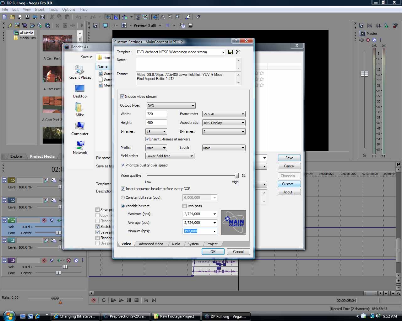

You entered the "minimum" value in the "Maximum" box. Therefore, average can't exceed that "maximum" that you entered. Put the minimum value in the BOTTOM box.

Thanks very much everyone. I'm rendering now with those values (in the right order) with a 2-pass, and I'm looking forward to finishing it up.
