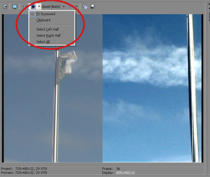

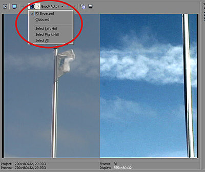

Problem: I add a new effect but I can't see any changes in the preview screen.
Solution: This is a feature in Vegas. Above the preview screen is the "Split Screen" button. Turn that off and you will now see your effect. You can also set left half/right half as shown in this image - the left half is the clip without the effect applied while the right half has the effects applied.

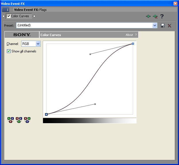

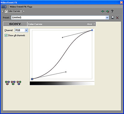

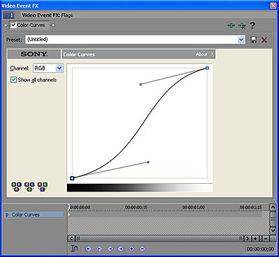

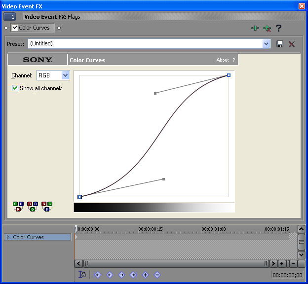

Problem: I add an new effect but I cannot set any keyframes because there is no timeline area.
Solution: The timeline area in the effects dialog is resizable. If you cannot see the timeline, it has been resized to "nothing" as shown in the first image.
Move the cursor slowly to the bottom of the dialog box and as soon as it turns into a up/down arrow, click and drag upwards to once again reveal the timeline area as shown in the second image.
