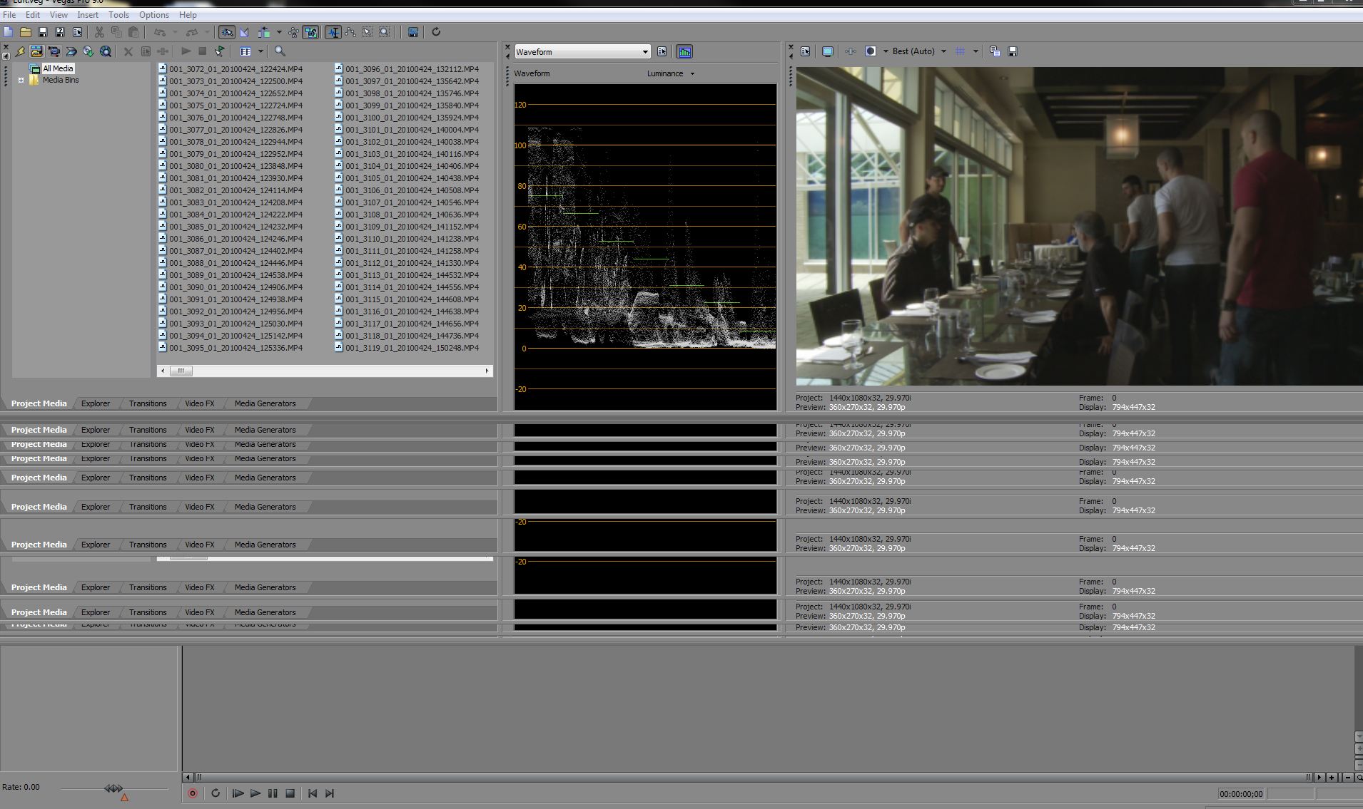

Hi all,

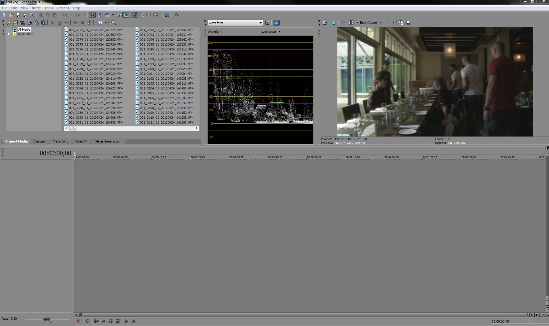

Images speak louder than words so please take a look at the screens attached. All of the sudden the timeline is completely blank. The shot you see in the upper right corner is the first frame of the first clip.
The second screen shows you what happens when I try to resize the timeline area, as if it was hung or something. Thing is the CPU is not all busy and Vegas is the only running program.
Also, you can't see by looking at the screenshots, but I can go to any point in my edit as if all tracks were still there. If I right click anywhere the options are the right one.

**** Edit ****
Well it looks like I can open other projects and they will be fine. The current project the is giving me grief has two veg files in it's folder, the current one and an old "trim" veg file that I haven't open in months....both could not be corrupted...
Hmmm kinda urgent...Blank timeline-vegas-blank.jpg   Hmmm kinda urgent...Blank timeline-vegas-blank-resize.jpg
