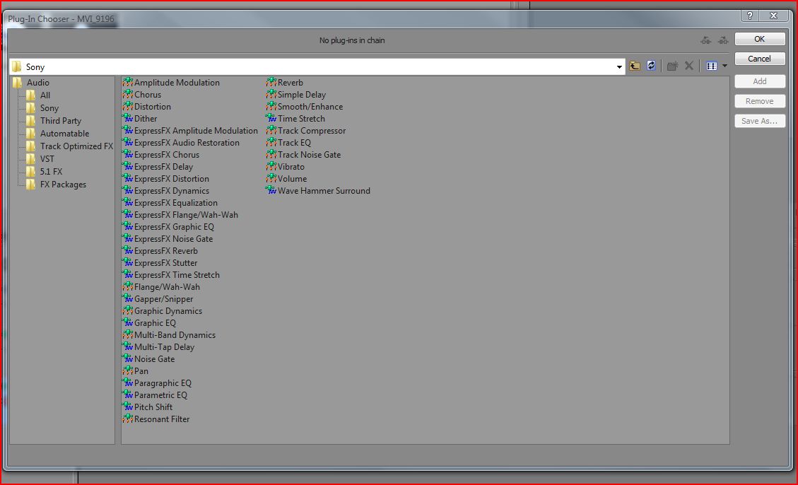

Actually there are all kinds of effects, including graphic equalizer available both for a track and for individual clips. The sound plugins are added just like video filters. Screen grab below shows what it looks like.

Chris, yes Vegas has FX but I thought the OP wanted a live graph that shows volume of the various frequencies as the audio plays. I think we've referrred to it as an EQ, but I thought he meant an audio bus type thing that shows volume levels at all frequencies. That I didn't think was available in Vegas.
