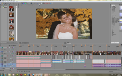

I don't know Gerald. A small preview window is only necessary if you don't know how to resize your preview window, which I'm sure Spiro does. Two monitors is nice, but please let's remember Sprio has specifically said he is doing basic editing. I don't see the need to push bigger and better when he clearly doesn't need it. He also says he doesn't have room for a second monitor.
I edit full time 5 days a week with a single monitor with no issues. I personally like to keep the focus on what is in front of me, rather than having to turn my head all day long, but that is just me.
Two monitors are nice if you have room and the extra money, but certainly not necessary.
Below is a screen shot of my entire desktop, and I always keep my preview window at that size, even with a four camera edit.

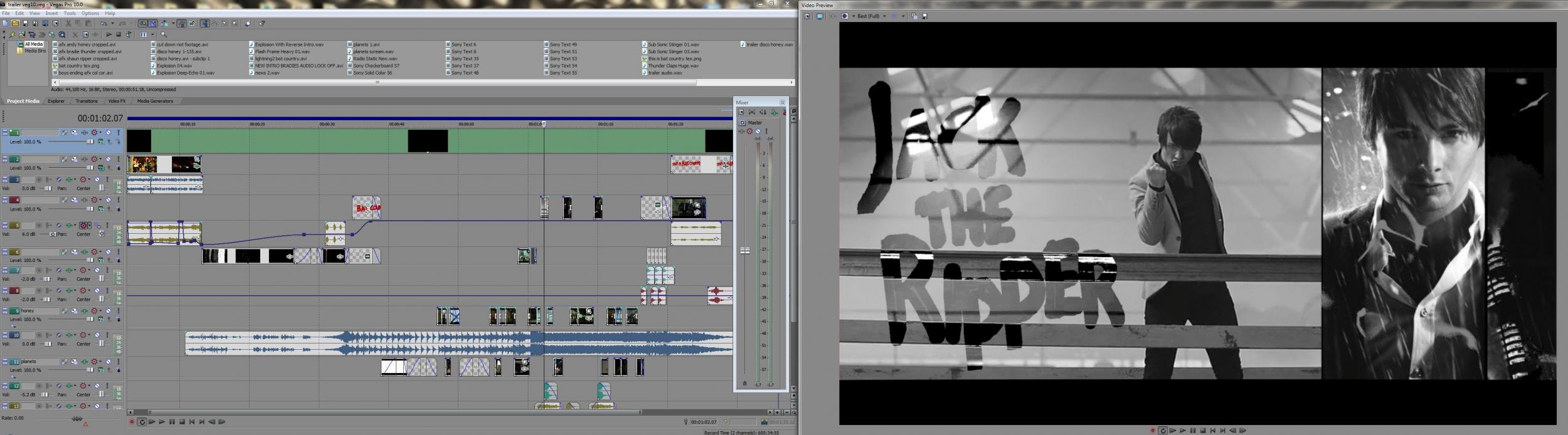

Im not saying you "need" a second monitor, just that before long I suspect most people would want one once they begin playing around with a few FX, layers, blend modes etc.
It just seems easier to me to be able to see my whole project all the time, with preview on a second monitor, rather than having to expand and reduce windows while previewing.
Another thing that is prob relevant, you are a professional, and no doubt your camera work is probably a lot better than mine and a lot of other beginners, I have a lot of white balance, levels, stabilization etc to fix up on my timeline, which I need to see, close up, if your footage is nearly perfect, straight out of the cam, I guess you may not need to preview as large or carefully.
This is a sample of the mess that i normally end up with, lol.
Still, to each their own. whatever works.
cheers Jeff
