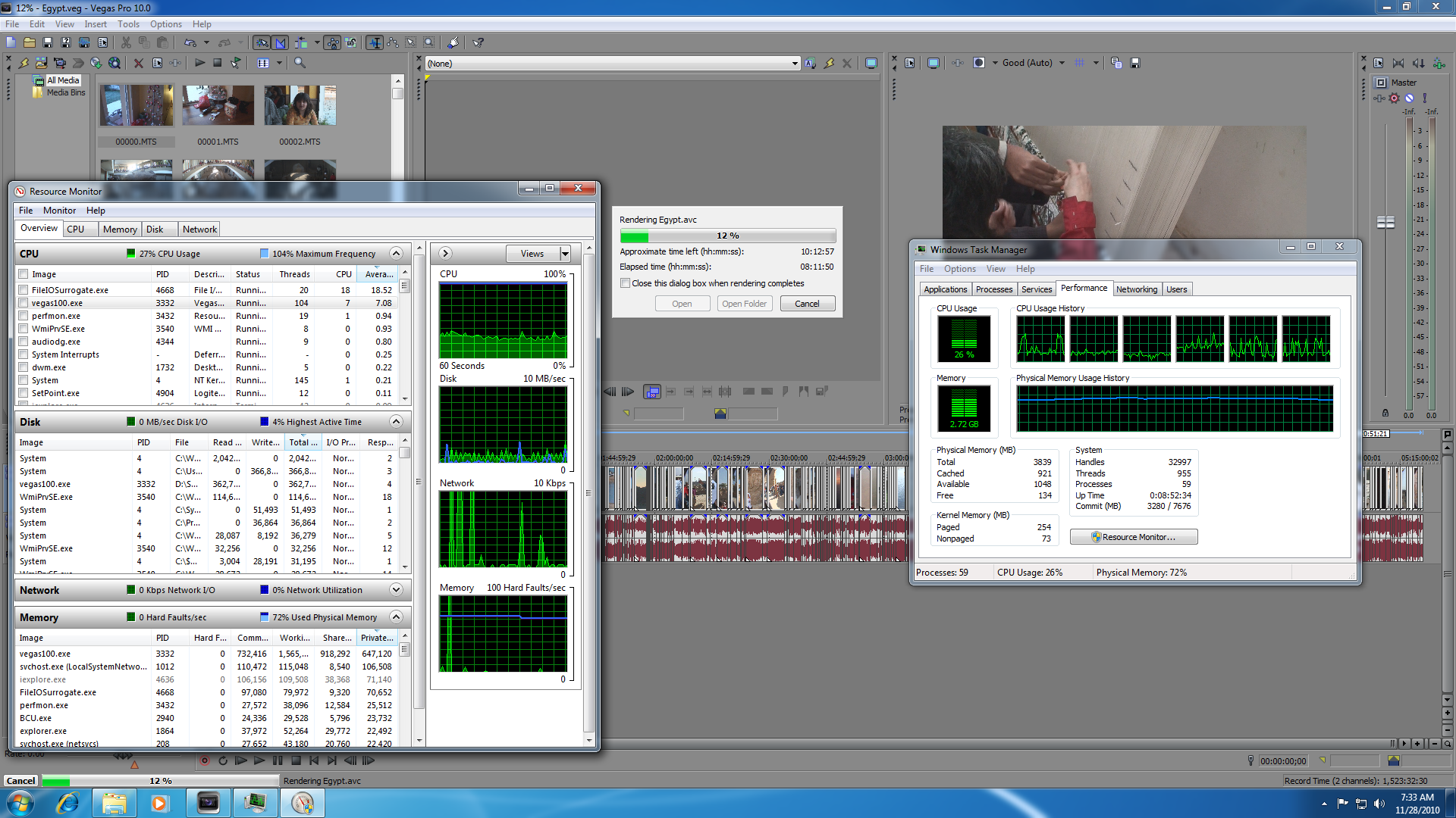

I am new at Vegas and just built a PC for the purpose. The PC is an AMD Phenom X6 (6 cores), 4G ram, ASUS M4A88TD-V (integrated video) MB. I have two 1T SATA drives, with source video on one disk outputting to the other. The OS is Windows 7 64 bit, with Vegas 10.
I am taking some video from my Sony camcorder and recoding it, basically just concatenating the files together as a first run, will use some fancier tools later as I get better. I am outputing to AVCHD, with the intention of playing it on the PS3.
What surprises me is that when I look at the resource utilization CPU is only at 30%, and disk utilization is also very low.Memory is at about 50%.... so where is the bottleneck? I was expecting the CPU to be at 100%. Obviously something is slowing it down but I can't see what.
I don't mind adding memory or a video card if I need to but don't want to just shoot in the dark. Any suggestions would be appreciated. I have attached a screen capture with task manager and resource manager running... the values shown are typical for the project.

Under Options->Preferences in the Video tab, how many threads are set as the max for rendering?
You mention this just being a basic concatenation of clips, but if you have any effect on that has a little yellow dot beside it, that effect cannot be run in parallel and will slow down the render.
Finally, there does appear to be a whole heck of a lot of clips, maybe there is some overhead in Vegas wrt opening each one, or handling the transitions that introduces some sort of serialization.
Nice machine BTW, sounds similar to what I want to build, except I'd put an ATI 58xx card in there.
How long does the render take and how long is the final cut?

And one other thing, even just using MS-Paint to convert that image to JPEG instead of BMP would result in a file at least 1/10 as big, if not closer to 1/20. BMPs are horrid things to pass around =)

It is normal to not get 100% utilization of your CPU. If Vegas was using 100% of your CPU, then the computer would have no resources left to run on.
Your question is common. It's not how much of the processor is used, but how fast the processor is, that makes the difference.

Mark, why do you expect your PC to run at 100% for Vegas? Where do you get that expecation? It is not printed or written anywhere. If it did run at 100% it would indicate the processor was being overworked, not that it is running well. 40%-60% is normal. But it varies a lot depending on the processor.
The numbers you should be looking at are how long it takes to render video, which you do not mention. You are leaving out the most important piece of information.
I render a 90 minute project in 20 minutes. My CPU runs at 50%. This is typical for my processor. This has been beaten to death in different threads, but I've not seen a "solution". This is a case where I'm not sure there is an issue to begin with.

I am trying to render some AVDHD video from a Sony camcorder into a simple AVCHD output which is basically just contatenating the files together. Once I get that basic thing working I'll spend time to clean up the footage.
I find that it is taking about 30% CPU and rendering a 10 minute project in about 60 minutes. I was hoping for faster and expected that with 6 cores Vegas would be able to take advantage of them. I have the preferences set for 16 threads, but that does not seem to do the trick to minimize the recode time.
I'm just trying to see if there is something stupid I am doing which is limiting the speed of the render; it looks to me like fileiosurrogate is the bottleneck (taking about 1 core of CPU) but I don't have any idea of why that is the case. I have done some searching and it may be that that is just normal for the kind of video I'm working with.
If it's normal then I guess I just relax and let it run...
