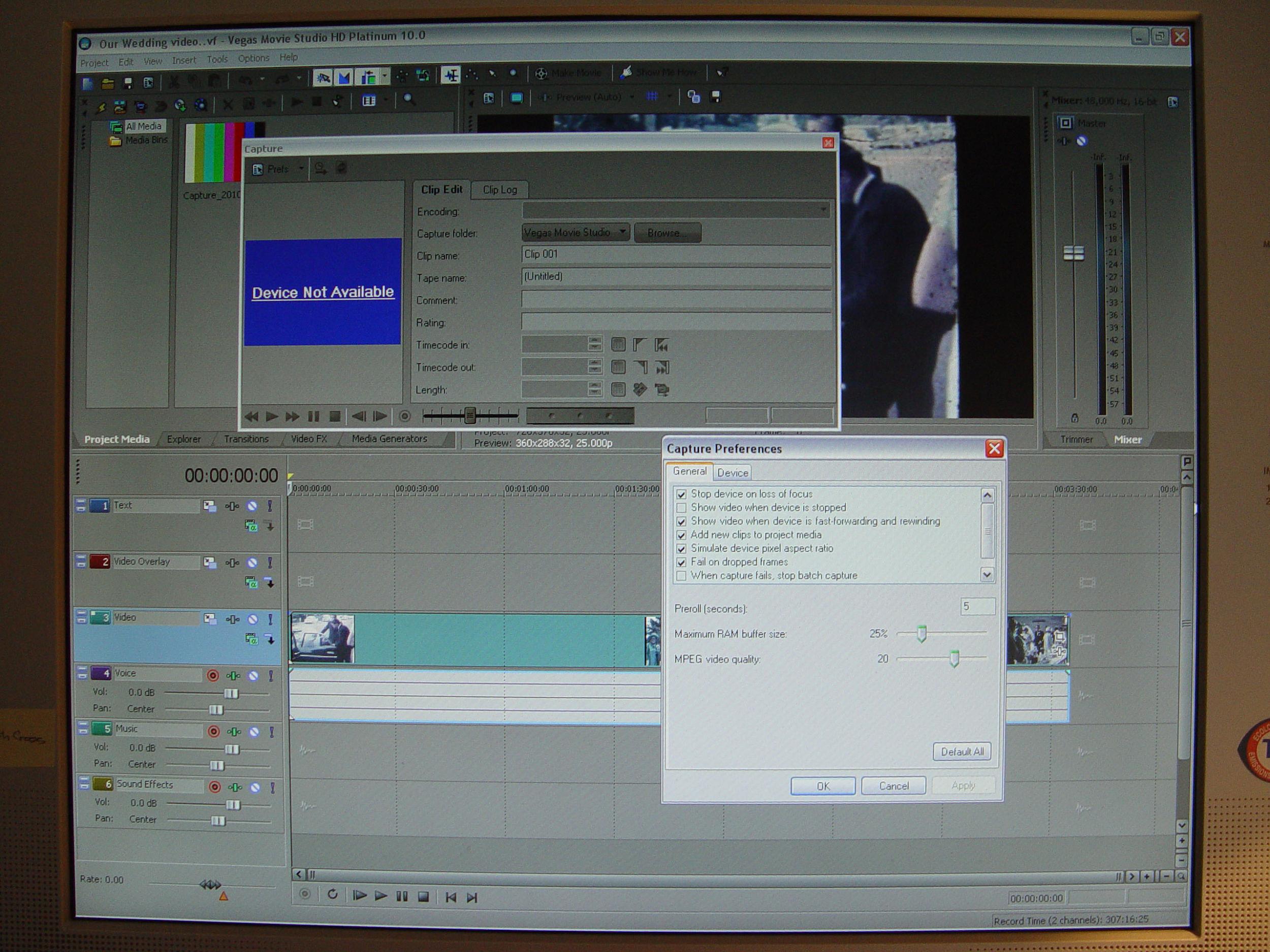

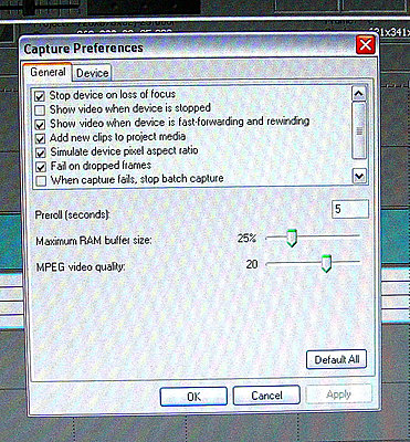

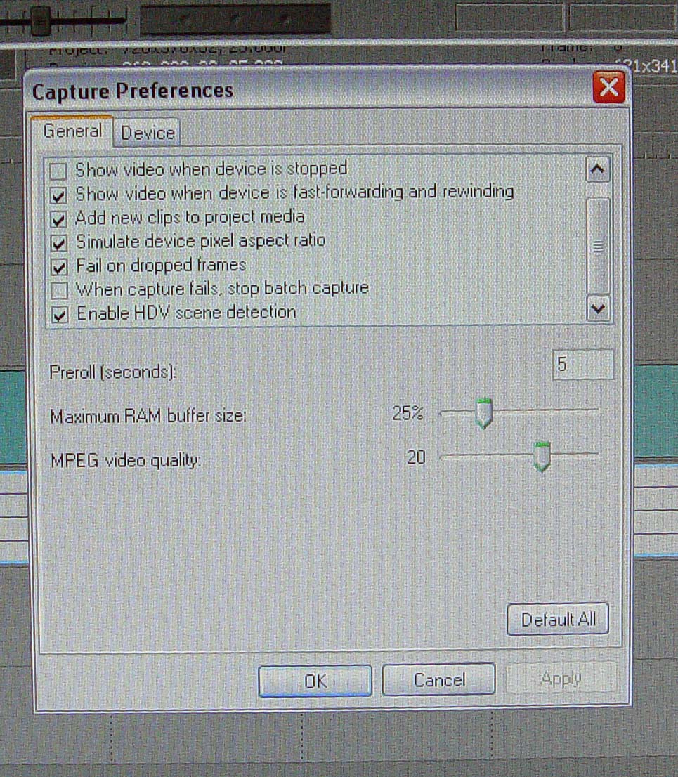

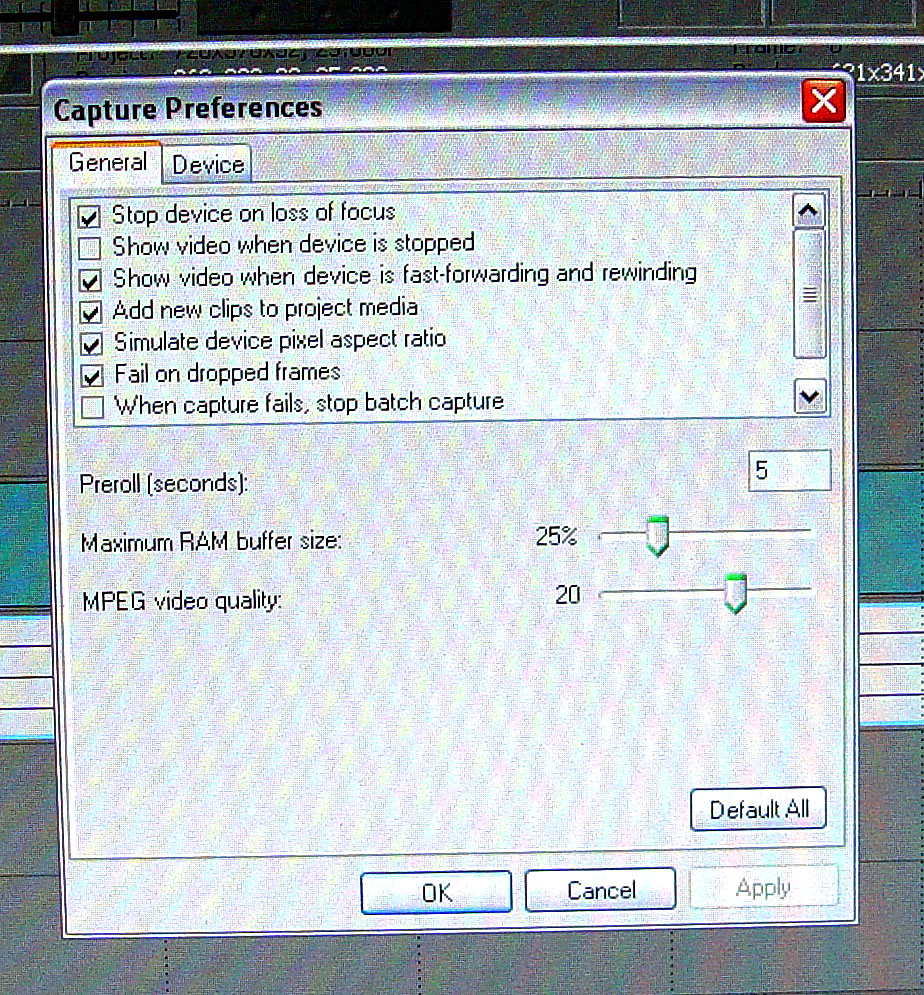

Thanks Robin for joining in the discussion. Good to see you have a copy of SONY Vegas Movie Studio HD Platinum ver10. I have included three pictures one of the screen after File/Capture/Pref's are selected then one of each extent of the 'pref' drop down. Thats all I get. Would love to see the screen you manage to get. Maybe I have a file missing with my program?? I normally work only in HDV but this was one occasion where I wanted to just capture some DV footage from my SONY HVR-A1P but to no avail. The camera settings are good as I think I have proved in the previous posts. I would value your or anyones response. Cheers, have a great Christmas. Its 25deg C and 80%+ humidity here in NZ.

Don't know about version 10 or VMS but didn't Vegas used to want an "external" capture program for DV? And there was some Sony capture program available as I recall. And the program had to be selected somewhere in Options.

This may be incorrect.
Your screenshots show the HDV "internal" capture app, and the capture prefs.
Strangely, capture prefs is not where you select the HDV or DV capture utilities.
In Pro it's in:
Tools | Options | Video | Use external video capture application | C:\Program Files\Sony\Vegas Movie Studio 10.0\VidCap60.EXE
You can also open vidcap60.exe by double-clicking on it in the above program files folder. Note that DV uses the "external" application, HDV is done with the "internal" application. Not very intuitive.

OK - I was able to take a look at a Vegas 10 installation, and went to Options-> Preferences -> Video and it looks exactly like all the other versions of Vegas that I have.
They still do DV the exact same way as in Vegas 8/9, ie they need an "external video capture application" and they have automatically filled in a link to VidCap60.exe which was automatically installed in the Vegas 10 program directory.
Have you checked to see whether VMS also did this? From what Robin said it looks like they are doing things exactly the same way as always even in VMS. If so all you would have to do is check the box that tells them to use the application they may have already installed for you.

I was just coming back to the forum to tell you all I figured it out, but you beat me to it. You recall I said I always work in HDV, well in Options/Preferences/Video tab the tick box for 'Use external video capture application' was unticked. That was a default I think. By ticking it when I hit the capture button a totally new screen appeared 'Sony Video Capture 6'. You are right its all there and has been all the time. I know I am covered in egg but it was worth it. Thanks all so much, so simple but its a show stopper if you don't know. Just shows me we never stop learning.
