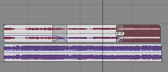

Wayne, for instances of needing to change volume levels when dealing with two audio tracks, (one voice and one music) I simply cut the audio at the points where the volume needs changed and raise and lower as needed. It is simple, and I don't have to fool with envelopes. I feel I have an easier time and more control.
I used to use volume envelopes, and I know that's how most guys do it. On the other hand, I often copy and paste entire projects to new instances of Vegas. With my weird way of doing it, I can copy and paste without having to be concerned with envelopes, etc.
