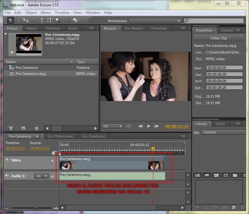

I've encountered a rather annoying issue with Sony Vegas 10. When I render out a project as a MPEG2 for DVD and use Adobe Encore to master my DVD I find that the video/audio track in the Encore timeline is separated which causes audio drift after a while. When I render using Vegas 9 the video/audio tracks are connected in the Encore timeline and causes no audio sync issues. Does anybody know what Vegas 10 is doing differently?

Rob the lag increases over time & the audio is contained within the MPEG-2. I spent countless hours/days trying to figure out what was wrong with my audio going through every scenario almost breaking down with frustration as my deadlines passed until I figured the only thing different is Vegas 10 and went back to 9 for final renders.
My current workflow is:
I edit & render my productions in sections eg. Pre-Ceremony, Ceremony, Reception in Vegas 10c. Then using Vegas 9 I compile all the sections into one time-line without re-compression.
This workflow works perfectly with Encore and video/audio is perfectly sync-ed, Vegas 10 somehow broke the audio, render setting are identical to Vegas 9. Although my V9 workflow works I would like to stop using Vegas 9 & figure out what wrong with 10. Rendering audio out separately (48kHz 16bit) also won't work, the video/audio tracks are never the same length.
