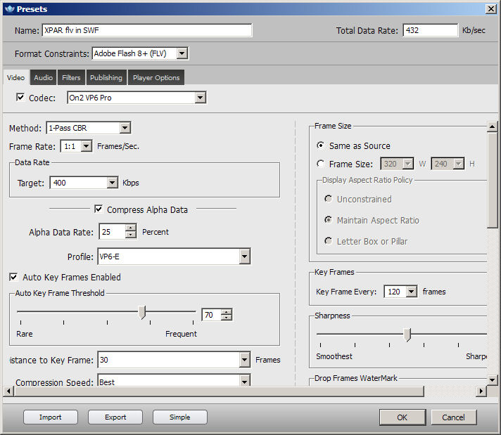

I'm back on Squeeze 6, but here is a snap of my relevant transparent flv settings.
Note that only Flash 8 / VP6 codec supports transparency. Not Flash 7 / Spark, not Flash 9r3 / h.264, not Flash 10 / .f4v.
Such a file will play in any Flash8 or later player install, but there are also some tricks to making it work on a web page, where I assume you're going. wmode=transparent is probably the most important param to set in the flash player embed.
Where are you having trouble? How did you create your flash player (if you've gotten that far).

Seth, thanks for your input, I was hoping that you would chime in. The seeting that i'm using look exzctly like the ones on you snap shot. The one thing that I will double check is the box that says
"Format Constraints". I have someone thats more famalier with webcode helping me so I can really explain how the player is being created. When I play the exported flv on the site, there is a white background behind the video. No transparency. The folks over at Sorenson suggested that I reinstall Sorenson to see if that helps. I am running the trail version which should have no limitations with the exception of a watermark. I will reinstall and see what happens. I will keep you posted.

I just checked format constraints and it matches your screen shot. Theres is aboxtitled profile which gice the options of vp6E or vp6s could picling the wrong one cause this problem? Also could the alpha dat rate be thue issue?

VP6e is the pro codec for standard def, VP6s was released later for HD - both should support transparency. I've not really benchmarked VP6s, as I haven't done much HD in flv. It would be worth looking at for HD.
Alpha data rate, which I have set at 25%, shouldn't affect the basic transparency, moreso whether it's good or bad transparency. I'd expect the "good" range to be somewhere between 10 and 25%, with 25 as a safe/conservative choice. Think about what Alpha is - it's a 256 level-per-pixel channel, just like the R, G, or B.
Has your web coder ever produced transparency with Flash video? There are so many places in a flash transparency workflow to get it wrong; I wouldn't assume that you're doing something wrong, it is just as likely to be the web coder if they're not experienced with this.

The source file is HD would clicking on VPe instead of S cause the problem?
