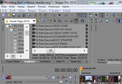

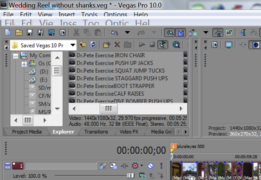

I have been working on a wedding reel, and one of the clips I used the stabilizer on. Ever since then, when I open the file, it messes up the whole screen and will not allow any of the FX plug-ins to work. Anyone know whats going on? I am pasting a screen shot here. When the screen changes it also makes the fonts on all the options and drop down menus REALLY small. Can barely read them.'
Notice how the drop down menus at the top now appear twice with one of them a larger font than the other one (the normal one). Ironically when you use the larger drop down menu the fonts under it are tiny.
Can anybody help us figure this out?

Wow! Almost an entire week and not one response. The good news is we figured a way to work around the goofy things that are happening to the drop down menus,etc.
I was really hoping that the screen shot of how the drop down menu now appears twice with one larger than the other might ring a bell with somebody if they have had the same issue.
I don't know if it has something to do with the project being edited on Pro 10 on my new computer from Pro 8 captured footage and vegas project files from my old computer. Those files were on an external hard drive now plugged into the new computer and being used in Pro 10.

I had a similar problem which was also not fixed by reinstalling Vegas. I finally was able to fix it by uninstalling VEGAS and then deleting the Vegas entries in the Registry. The problem is that many of the setup variables remain in the Registry after uninstalling Vegas and if one or more of the values are incorrect, the problems that result remain after reinstallation if they aren't removed from the registry first.

Vegas can be reset back to factory defaults by holding down CTRL-SHIFT when starting Vegas which may have done the same thing as totally removing and resinstalling.
