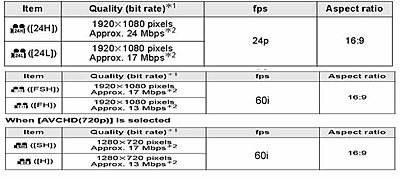

As you can see from the attached chart, my camera shoots at a full 30% higher data rate (24mbps) in 24p mode than it will in 60i. That is why I asked if it would be advantageous to shoot in 24p, because of the higher data rate offered. In all other modes, the camera only offers 17mbps or less. The extra data sounds attractive.
The sensor in my camera is 4/3" so I am working with a decent-sized sensor. But while I do have a conservative shooting style and stay on tripod virtually all of the time, I do have concerns about the jerkiness of 24p.
I suppose I will just have to try it out to really know. Many that shoot in 24p are merely obsessed with the film look, I am not. Don't get me wrong, I would love to have a cinematic look. On the other hand if it's going to look worse after running through the TVs and/or Bluray player's process, than it would not be advantageous and would be foolish.
Bottom line, I wonder if the extra data would make for a superior image despite the conversion process in the TV and player.

Yes 720P may give a nice picture in most situations though I am a little confused by the comment to record at 60i in the data sheet. Must look at the information on the GH2 again. I do not shoot weddings all my projects are theatre so requirements are different. I want large depth of field not shallow, smooth movement etc almost the opposite of the film look !!! My NX5U records at 24Mbps and the XR500 at 17, frankly I can't see much difference for most subjects. Leaves blowing in the wind and grass etc then the NX5U has a cleaner image with more detail. For faces the XR500 with face recognition results in a better picture than the NX5U which requires too much manual control to achieve the same image.

Yes I think 720P60 would require a higher data throughput than 24P at 24Mbps so it may be the processor limit in the camera. At 24P there will be a need to encode 49,766,400 pixels a sec. At 1280x720P60 there will be 55,296,000 pixels to encode every sec. At 1920x1080P60 there would be 124,416,000 pixels to encode every sec. So you can see how the processor load increases. Interlace will be half these numbers. Since these really also represent the definition of the video it also indicates which will look the most detailed if they are all played back at 60P on a flat panel display. 1920x1080 interlace still has more pixels displayed per second than either 24p or 720p. assuming equal encodes. This may also explain why its possible to encode 24p at 24Mbps while only 17Mbps for higher frame rates. Probably represents the same processor load.

What you say make it seem logical. On a somewhat related note, interestingly the GH1 has been hacked by nearly everyone who owns it to shoot 60p. It does look great.
