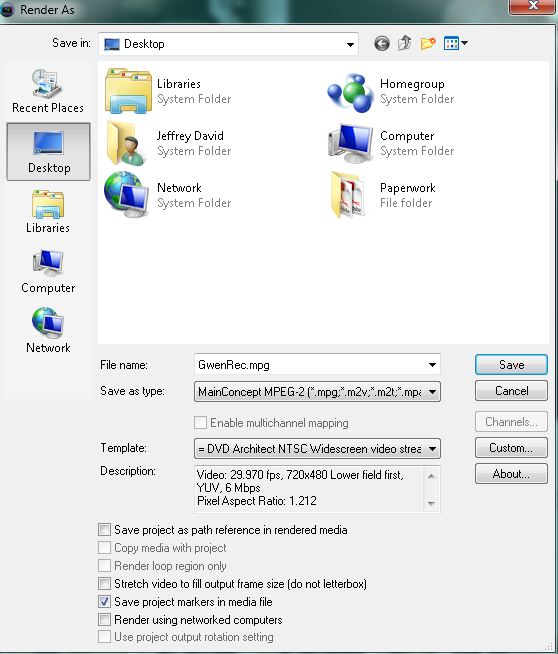

You should render as shown, in the attached clip, unless i'm missing something.

Sorry, you're trying to burn from Vegas, missed that. I've never done it. I always have rendered for DVDA, then burned from here.
