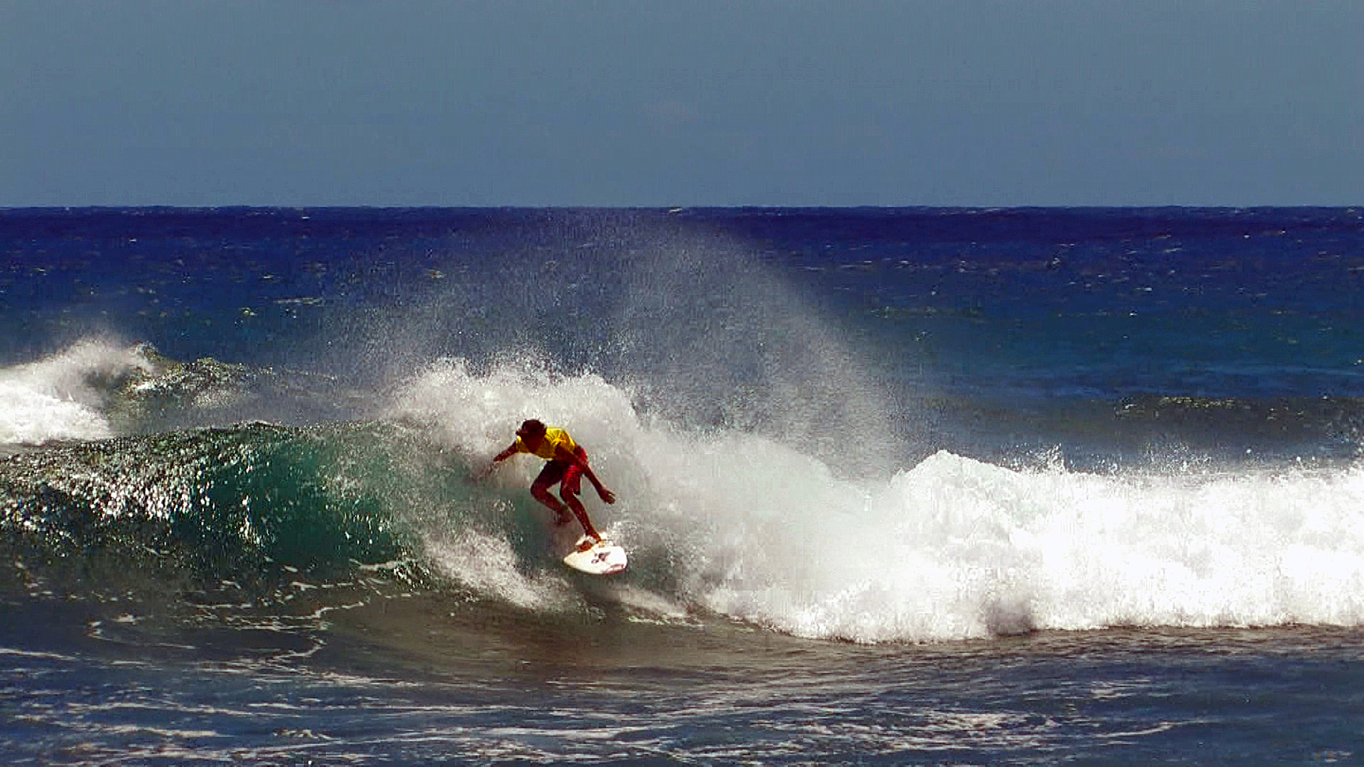

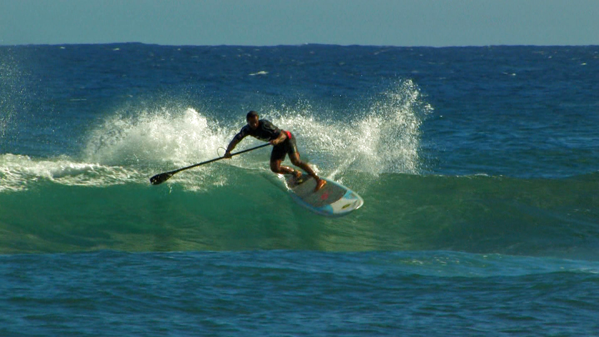

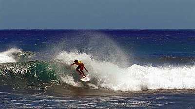

I took a couple of frame grabs, plugged them into Adobe Photoshop 6, pressed 3 buttons, 'Auto Smart Fix', 'Auto Color Correction' 'Auto Sharpen'. I'll admit I'm a dunce when it comes to color correction in Vegas, and am wondering if there are 3 quick steps to get similar results using Vegas Pro 9.

Here's a rather long-winded reply from a few hints that I've collected over the years.
The four numbered steps are the first ones to play with to get comfortable with the process.
1. Drop color corrector on event
2. On right wheel, click left eye dropper, then click/drag on white in preview
3. On middle wheel, click left eye dropper, click/drag on flesh or neutral color in preview
4. On left wheel, click left eye dropper, click/drag on black in preview
You can often skip the middle wheel once you have black and white set.
This is especially true if your image doesn't have fleshtones to select.
If you have good light on event, you can use auto levels for quick fix (an FX).
You can use levels FX before you use CC also.
Use the highlights eyedropped (negative sign / complementary) on a highlight that is supposed to be white.
Click-drag the eyedropper over an area... this averages out noise.
Then do the midtones on something that is grey (supposed to be grey).
If the highlights look funky, drop on the secondary CC.
Limit the range to highlights, and de-saturate.
edit:
check out Vol. 6 #2 of Edward Troxel's newsletters for an excellent tutorial on this topic.
http://www.jetdv.com/vegas/forum/viewtopic.php?t=54
