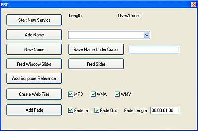

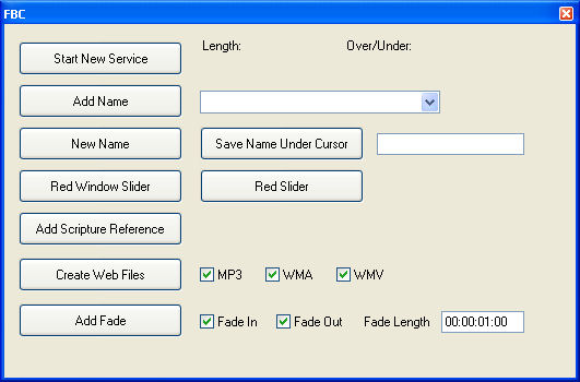

Wade, while Excalibur could automatically adjust the images for you, I'm not using Excalibur. I have a specially written script designed specifically for our edit. It's a simple layout - you can see it attached. Here's how it works:
Start New Service loads the base template, adds this weeks service to the timeline, and saves it under a new name. To the right are some indicators showing the length of the timeline and how much over/under the program is from the specified airing length.
Add Name and the drop down list will let me choose from a list of title images we've created and drop that name on the timeline at the cursor location.
New Name will let me add the lower third/generated media so I can type in a new name if it's not in the list. I can type the name in the box to the right and click on Save Name Under Cursor to add that name to the list.
Red Window Slider/Red Slider will both add a lower third that slides in from the right using Pan/Crop and a generated media for adding the title.
Add Scripture Reference adds a background image for the scripture and generated media where I paste in the text from Bible Explorer.
Then I added the Create Web Files to render the final output to multiple formats so the files could be placed on the web. We are not currently doing so but we may in the future.
I don't actually use the "Add Fade" anymore.
But I definitely don't see why a custom command couldn't add your images to the timeline, properly resize them, and even add the desired transitions for you.
