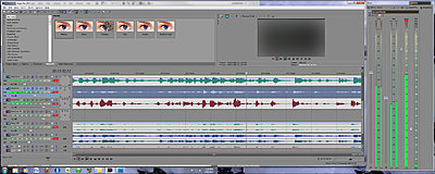

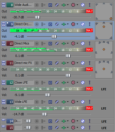

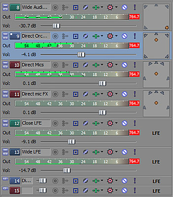

So I am working on an NTSC 720x480 29.97p 16:9 5.1 audio project with 2 HDV sources and 2 independent pcm audio sources and my track and mixer meters are acting weird. Sometimes the mixer meters freeze and nothing happens sometimes the track meters show peaks way above what is possible. In the example I will post here, the track meters are showing a max peak of 767.4db.
What is going on here? Any thoughts? Is this a bug or a user error?

To answer your question, no i am not using any envelopes. And to clarify, the audio is not loud or going off the charts anywhere near these numbers. On these 5.1 projects I remix direct mics, direct music (orchestra mics) and on camera mics to get the sound the way I like. I then make a pass through using the meters as a guide to keep the audio between -21db and about -1db with an average around -12db overall. The meters are crucial during this phase. Once the audio is leveled out, then I go back to cut the video and switch between the wide and follow cam angles and do any vid EFX needed. The last phase is adding any sweeteners needed to video or audio and reconfirming scopes and meters again.
With the meters being so weird, i am not getting accurate readings and cannot be sure I am hitting my marks.
