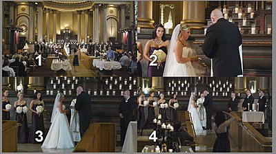

Not knowing what online videos you have seen and are comparing, I suggest the number one thing that determines great skin tones is camera / lens choice. It all starts with the lens, and goes pretty much downhill from there.
I'm working now on a wedding shot with an FX1 and two DSLRs (actually they are hybrid cams, but that is beside the point for this discussion). There is no possible way I could ever match the tones of the DSLR footage with the stark looking FX1. Admittedly, my white balance settings could've been improved on the FX1, but the DSLR footage is even easier to color correct in post then the FX1.
Below is a sample from another wedding shot with four different DSLR stype cameras simultaneously, you can see how rich the colors are, and how bright things are with cameras 1 and 2. But 3 and 4 are different due to lens differences and probably bad white balance. But the differences are striking, IMO.
I could never have achieved these looks on cam 1 and 2 in post. I'm not saying they are groundbreaking, or anything like that. But it is so much easier when you start with great footage.
Grading advice in Vegas / Magic Bullet Looks and Alternatives-joann.jpg
