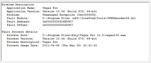

Tried encoding this file twice, both versions crash Vegas.
Will import ok, even open and play in trimmer.
But when dropped on the timeline, it pauses and then packs up.
The file is a Cineform avi.
Thanx in advance.

Your attachment clearly shows it is not Vegas that causes the crash, it is the Cineform decoder. You should forward the information from that error message to whoever produces the Cineform codec because the error message suggests there is a bug in it.
I am puzzled about one thing that error message shows: It seems to be a 64-bit codec that is installed in the directory for 32-bit programs, i.e., a subdirectory of C:\Program Files (x86). Unless you explicitly told the installer to put it there, it suggests the installer may have thought it was installing some 32-bit software. Since the registry on 64-bit Windows uses a different layout for 32-bit software and 64-bit software, the problem might even be caused by an entry written to the wrong section of the Windows registry (written there by the setup software when you installed the codec).

I reinstalled Cineform Neo just to check, Im just assuming it knows where to go.
The file opens fine in Premiere, After Effects, First Light ( Cineform CC software) and WMP.
Could it still be a prob with the codec if its just not working in Vegas?

That’s what the error message says. And that message comes from Windows, not Vegas. So, yes.
