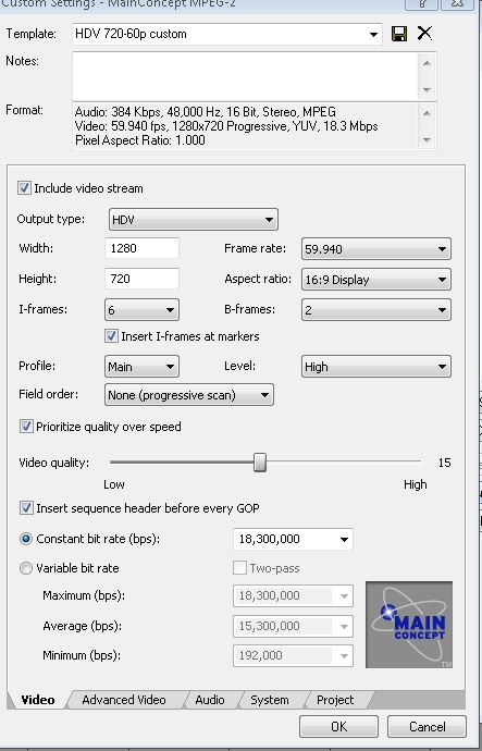

Re: Render settings for mix of 1080p24 and 720p60
I fashioned my Vimeo template from a 720 30p template, I believe. It is an excessive bit rate, files are huge, and probably unnecessarily so, but it is what I use and it works well. 1080 is absolutely overkill for internet, first off, so stick with 720p, IMO.
I've messed with my settings, and it always come out worse, so I just stick with the below settings for lack of how to create high quality files that are smaller. I'm sure it can be done, I just haven't had time to devote to it.
I'm not recommending my settings, but am only getting the ball rolling here for you. I will say though you can use my settings for guaranteed quality, but there is, in your case the issue of 24p footage. I have no idea how that will come out, sorry.
thanks for the post, Ya i was just wondering if I should output a 1080 file or a 720 file, sounds like I'll just stick with 720
