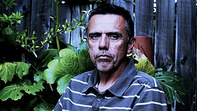

Old July 20th, 2011, 09:33 PM   #24
Location: Elk Grove CA
Posts: 6,838
Re: Sony and Magic Bullets - big disappointment
Okay, since no one has posted anything yet, does someone want to try to grade the image below using Magic Bullet, so that others can try to match it with Vegas stuff.
Chris J. Barcellos

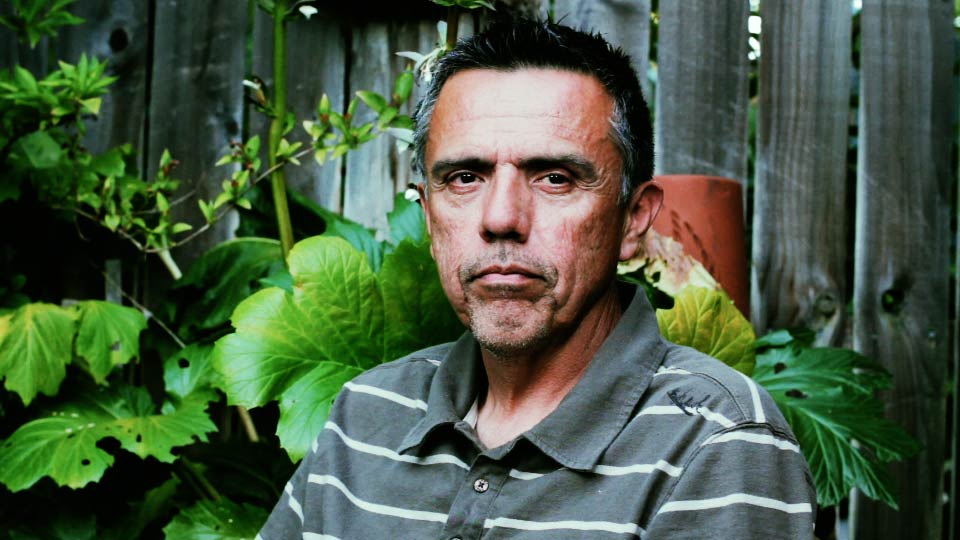

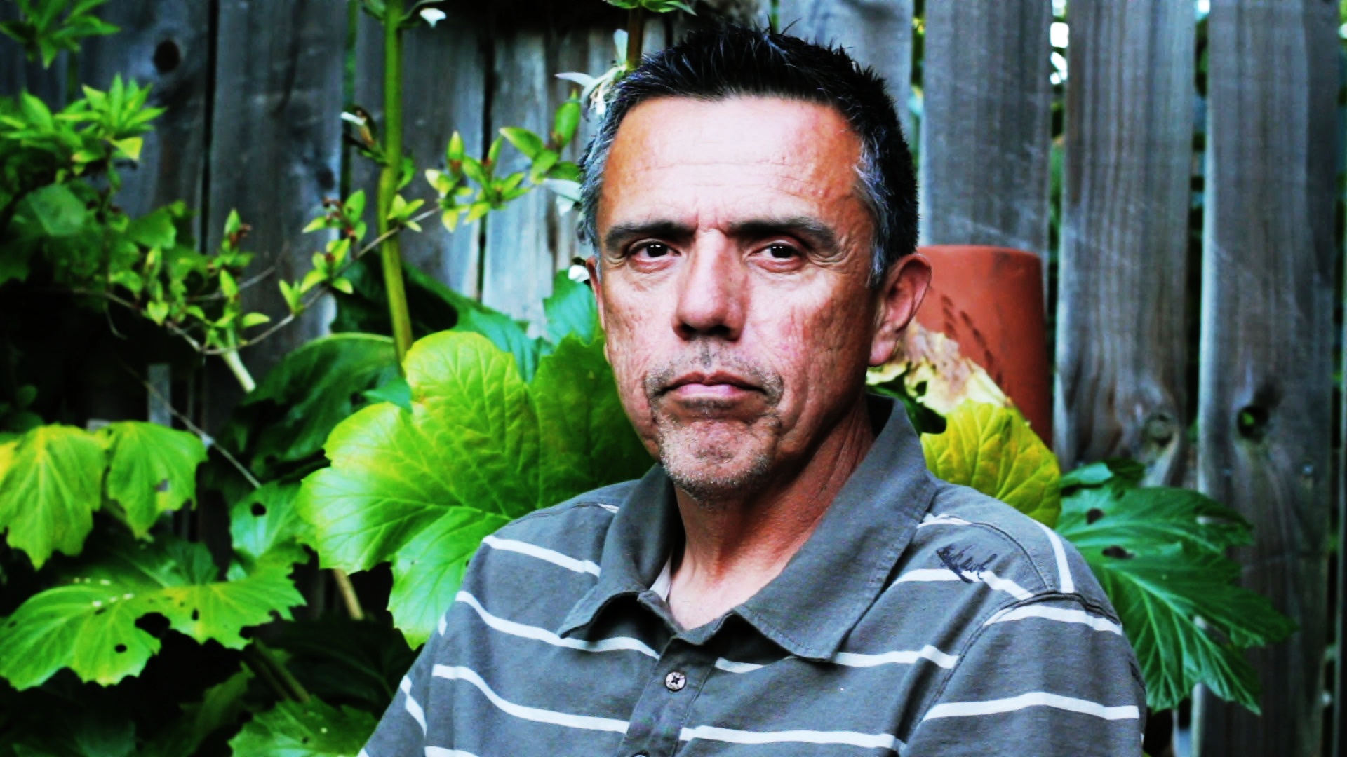

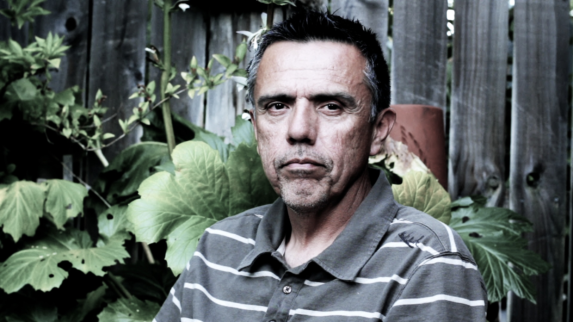

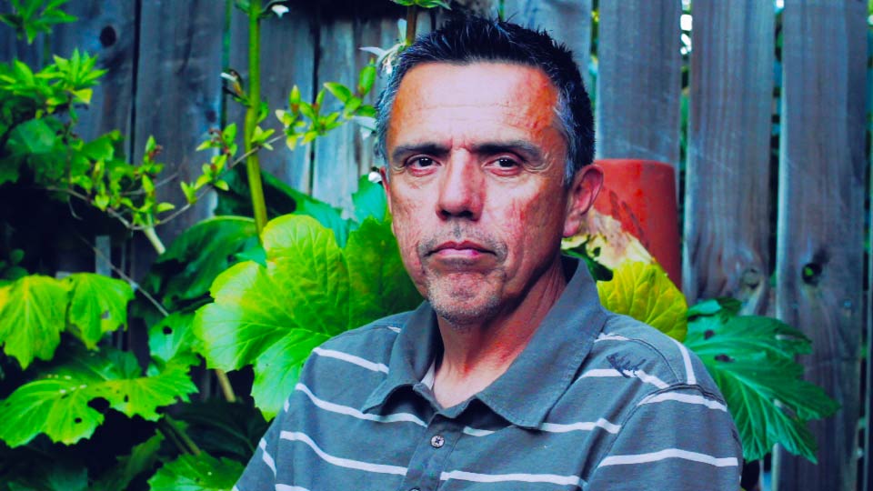

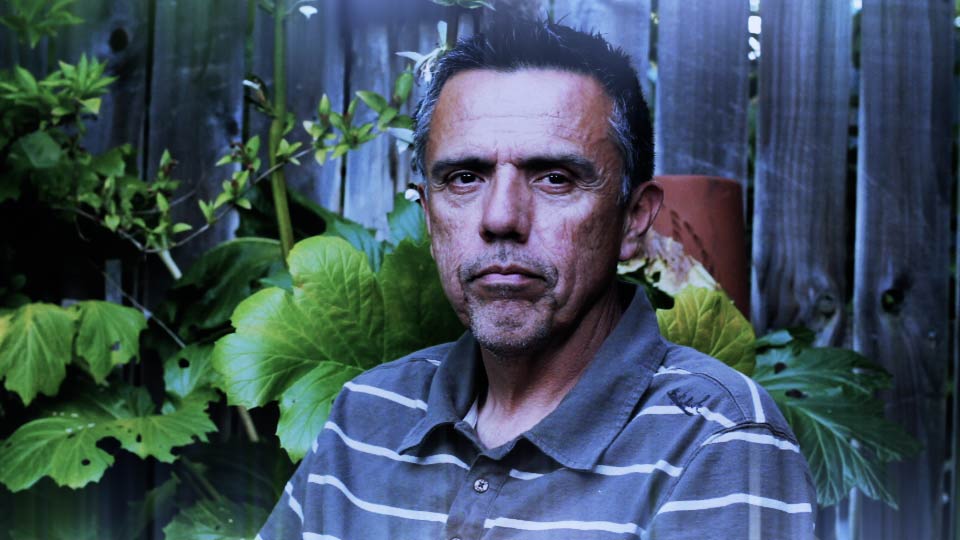

Old July 21st, 2011, 05:31 AM   #25
Join Date: Oct 2009
Location: Central Coast Australia
Posts: 1,050
Heres a few,
make requests if you want.
Tried to do some subtle ones, if you want the extreme ones done let me know.
Sony and Magic Bullets - big disappointment-40-shutter-streak.jpg   Sony and Magic Bullets - big disappointment-85.jpg
Sony and Magic Bullets - big disappointment-bleached.jpg   Sony and Magic Bullets - big disappointment-col-reversal.jpg
http://vimeo.com/livewebvideo
Gerald Webb is offline   Reply With Quote

Old July 24th, 2011, 12:02 AM   #27
Posts: 6,838
I did all five of these with close matches using Vegas to grab frames. I actually just took the photo and rendered to a 5 second Cineform .avi. I then took the clip in Cineforms First Light. I looked searched through the various preset .luts and was able to come up with a very close match on all of these. I woulld select the .lut. go to Vegas grab a frame, select another .lut, and grab, etc. Took all of about 15 minutes.
Sony and Magic Bullets - big disappointment-matchshutterstreak.jpg   Sony and Magic Bullets - big disappointment-match85.jpg
Sony and Magic Bullets - big disappointment-matchbleach.jpg   Sony and Magic Bullets - big disappointment-matchcolreversal.jpg
Chris J. Barcellos
