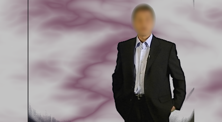

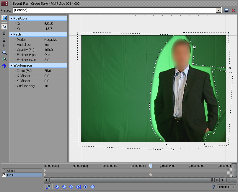

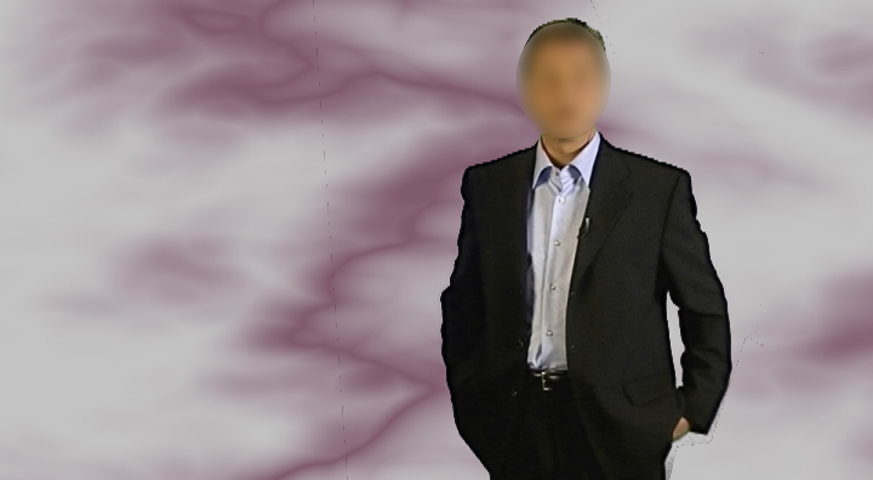

Renton, here are a few screen shots that I hope will clarify things for you.
I didn't light this but had to work with the footage afterwards :(
I used the Mask feature (3 masks in all) in Pan/Crop to get rid of the areas I didn't want to see.
Take note of the mask settings in the Path menu.
He didn't move around so I could set my masks very close to him.
This wasn't necessary but I wanted to show you that you can get away with a very small green screen (this one was 10 ft. x 12 ft.) and still get good results.
Considering what I had to work with, I was pleased with how it turned out.

Mike's illustration is excellent. Of course, more often, you're drawing 4 points to make a large box. But, as Mike shows, bezier masking tools allow you to make a shape of any complexity, and they can even be keyframed to follow an object or person. I did that on a project a couple months ago - with amazing results - but very time-consuming.
What is outside the box does not "turn green", for later chromakey, it becomes transparent. All that dark-green area of M's P/C window is actually transparent on the timeline.
Note also David J's post #8, above. It's an important point. Recent versions of Vegas allow you to specify not only the order of video fx application, but also, where in the chain pan/crop is applied. To change this order, open up the video fx for the clip, and drag the pan/crop button to the left to place it earlier in the order of execution.

So...rather than make the whole background green, which would then be extracted and made transparent with the chromakey tool, all outside the mask is non-selectively extracted to obtain the transparency needed, and then what's left of the green is extracted as a separate process via the chromakeyer?
Do you do two separate renders, first to get the result from the garbage matte and then that from the chromakeyer, or do them both at once.
If there is unevenness of lighting across the screen, this could aid in keying, couldn't it, by reducing the variation that needs to be selected by the keyer? I've got a pretty good screen but I've noticed that some times it doesn't all extract evenly/equally...

One render is fine. You can do both the chroma key and the pan/crop mask at the same time.

That's right. As Edward points out, you typically would only render once, which would be your final composite, to include your foreground subject over your background images or clips.
