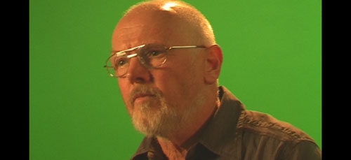

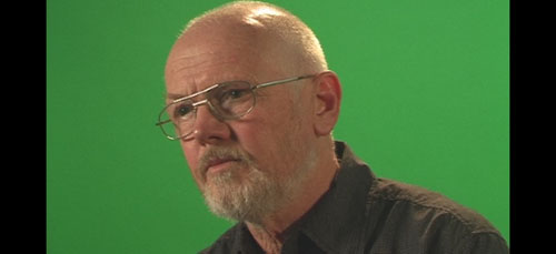

I'm doing a major production (for me) which involves filming with four cameras which are all effectively the same...though obviously from different angles. I've locked the focus and aperture down etc but I've come across an interesting thing, which I'll show by the two photos below. They are screen shots from video from the same camera, with lights etc all identical. Yet one video is considerablly more golden/brighter (right image - as though you can't tell!) and is out of sync with all the other videos from all the other cameras - and with video from the same camera from other film sessions (left image). I don't know why there is a difference with this one camera during this one filming session, But I would like to bring the odd video in line with all the others colour wise. It seems to be a 'global' difference.
Any suggestions on how to go about this? I'm using Vegas 10 Pro

If it is auto white balance, I could only be that I may have switched this camera on before the green screen lights - though I don't think I did that. Otherwise there is no reason for any difference in the white balance as everything is identical between shoots. AWB in such situations shouldn't change - should it?
If it is a WB issue, is there any way to globally adjust WB to bring the clips into line colour wise?

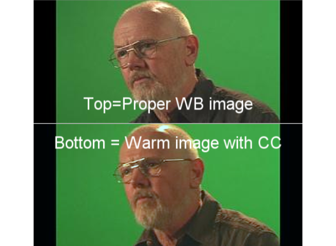

AWB can change for too many reasons to list, that's why it's always best to manually WB however the real question is can it be fixed? The answer is yes. Vegas has some of the best CC tools around.
Set both clips on the timeline, take a snapshot of the good one, (not a freeze frame, a snapshot to the clip board) move the cursor to the one you want to fix, split the preview screen (icon over the preview screen) open up the CC FX and have at it. I'll try to get you some settings shortly, I'm rendering a peice right now but the fact is it can be done.

Here's some info-Hope it helps

Great job Don, they look identical!
Kevin Lewis is offline   Reply With Quote

Thanks but actually the gamma of the lower one could stand to be dropped a tiny bit but I'm just being super critical and the image is still a tiny touch off but frankly for 2 minutes spent on it I'm pretty happy with it.
