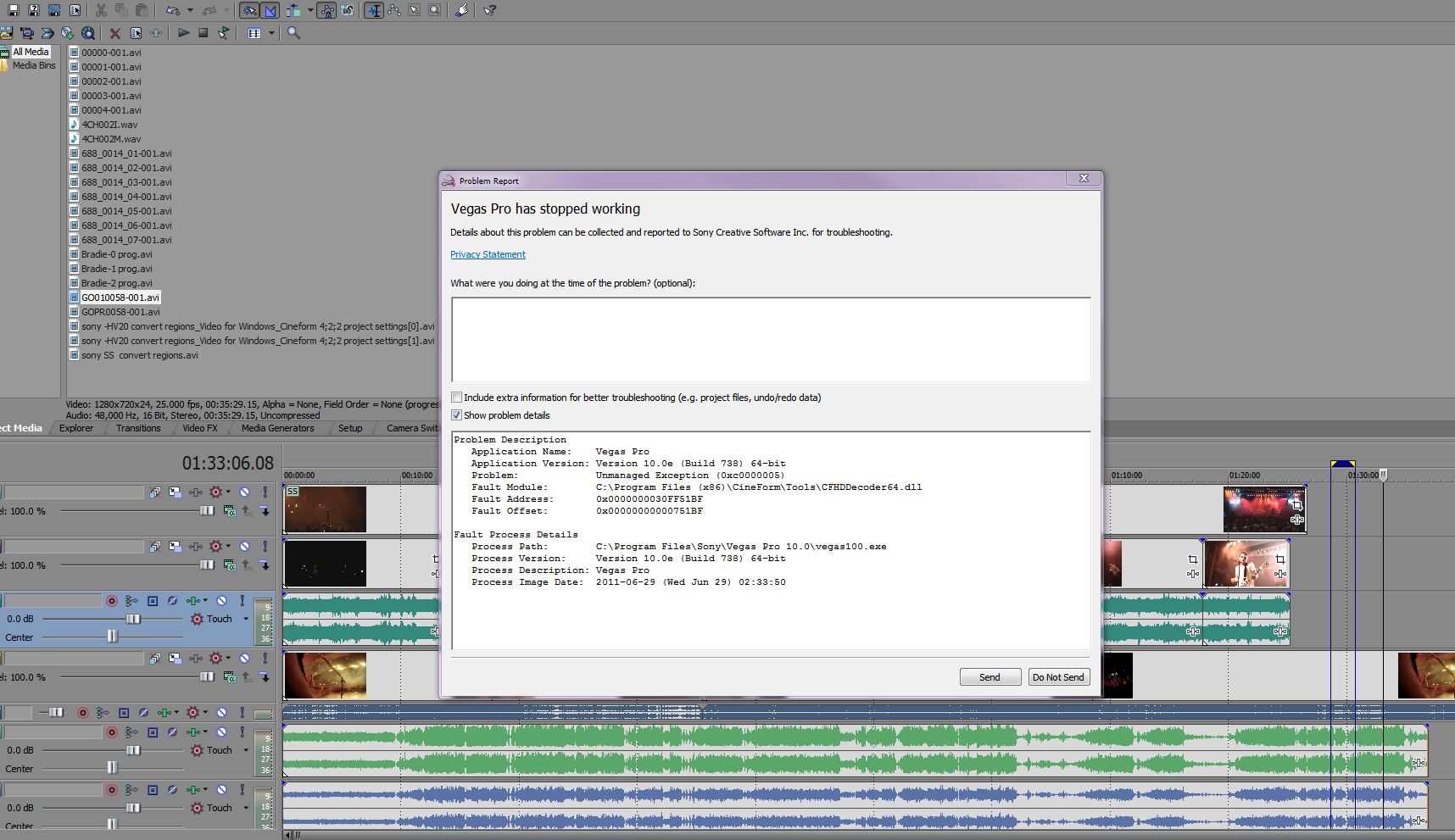

Can anyone help with this,
transcoded about 11 hrs of footage to Cineform,
Got 8 tracks of 1080p on the timeline synced and ready to rock and it is crash city.
Just resizing the preview or changing quality=crash
Scrolling open the timeline=crash
Cant work for more than a min or so without fail.
Even had a BSD.
this error every time,
Cineform seem unsure, just asking about UAC and which version of Neo (updated last week).
Im hoping they get back with something positive, but wondering if anyone here has a fix.

Old August 2nd, 2011, 01:59 AM   #7
Join Date: Oct 2009
Location: Reno, NV
Posts: 553
Re: Wish me luck...
Transcode everything to standard definition DV in AVI files. Unless you have a hardware malfunction, editing DV in standard definition should be crash proof. If you need a blu-ray master, swap the standard definition AVI files for high-definition ones just before the final render.

thanks guys,
last night in despair I ran off some 1024x576 Cineform files, been playing with those for an hour or so and it seems stable, so now I'm thinking its my PC cant handle the big file weight, i just dont know.
Yes, 8 is a stretch, I'm going half speed and looping each verse and chorus to find the best shots, TBH its doin my head in. May have bitten off more than I can chew, lol.
I still think something has changed with Cineform, ive done multicam 1080p projects on this PC b4.

Update to maybe help someone in the future.
Had no joy with 1080p Cineform files converted from multiple AVCHD, MXF and HDV cam files. The original cam files and captures were converted to Cineform in folder group lots by HD LInk, thus ending up with multiple Cineform files laying along side the raw files in there folders on a 7200rpm drive.
I got the files synced in Vegas but after that it went downhill pretty fast, crashes every few minutes or more, sometimes the project would just crash on load.
BUT,
Re encoded the raw files to Cineform in Vegas, thus making one massive file for each cam, rather than 2,3 or 7 files (in the case of the MXF cam) sitting together on the timeline, (also applied Neat video and levels in the encode).
Now I just have 7 big files for 7 cams, all on one 7200rpm drive.
It plays like a champion, Full screen multicam playback on second monitor with color management WHILE applying primaries and looks in First Light. Did 2 hrs of editing and coloring with not a single crash or stammer (even had preview on best before I realised and put back to auto).
Why is it different? dont know.
Next time Ill save a few days of rendering and just convert in Vegas.
