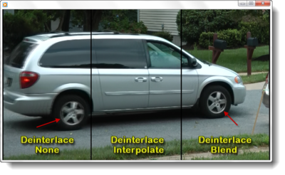

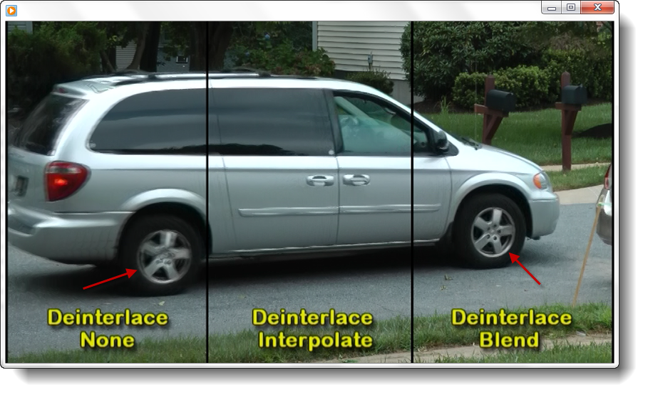

Okay, false alarm. It works as expected. I took a 1080i source clip of a moving car. Resized it to 720x480 NTSC WS (MainConcept encoder). Three passes: once with Deinterlace=none, once with Deinterlace=Interpolate, once with Deinterlace=Blend. I can't see a difference in the Interpolate and Blend, but the Deinterlace=None ain't so great:
...Jerry
