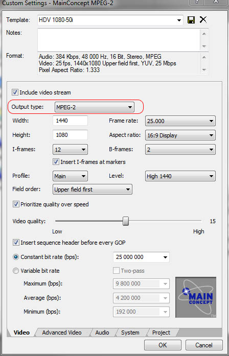

Try this (see attachment) change your "Output type:" to "MPEG-2" instead of HDV. Whenever I render something out that is not set to MPEG-2 I get out of sync audio.
I'm desperate! 1 year of work:out of SYNCH-audio-sync.jpg
