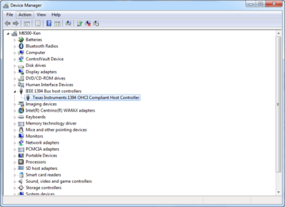

Thanks for replying Graham. I've attached screen shot of Device Mgr showing driver I'm using. How do I know if I'm using a legacy driver or not? When I look at the driver in Device Mgr there's nothing to roll back to.

Here's a hopefully helpful post from a user on the Sony Vegas forum about legacy drivers.
Go to Device Manager and find your firewire device. Update drivers and select the option where you can choose from a list. Choose the firewire driver that is not being used. On my computer I had a Windows 7 driver, a legacy driver and another one. I chose the last one and all of my firewire cameras and Canopus device started working.

Thanks Mike for the detail. I gave it a try and the problem is here.
I made a screen cast of how to change the driver to help anyone else that might need assistance.
Using the link below, scroll down through the Tips section and then to:
How to Revert Back to a Legacy Driver in Windows 7
