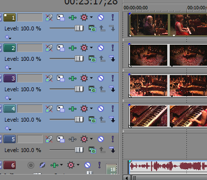

I am trying to use it for the first time and I can't CC. I CC each video track but it doesn't work (see attached). What needs to be done to use CC files in simple multicam editing. IT IS NOT A ROCKET SCIENCE, SONY!!!.
Is it possible at all?
(but please don't tell me that I must render each file with CC before I use it in my project, it would be just plain stupid).

You have to color correct the MEDIA on the Project Media tab. Then it will carry across to the Master track. You can't color correct at the track or event level and use the built-in multi-cam feature.
If you want to use a third party multi-cam (i.e. Excalibur or Ultimate S), then you can color correct at the event level and it will be carried over to the master track.

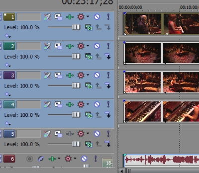

I thought I did it (I color corrected the main media tabs of each track - see attached image) Isn't it that Media Tab you are referring to?

No. You added to the TRACK. Look at the tabbed area above where you have Explorer, Transitions, Video FX, and you'll also see one called Project Media. Go to that tab and then do your color corrections there. At this point I would copy the color corrections from your tracks to the correct media in the Project Media tab. Then you can delete them off the tracks.
