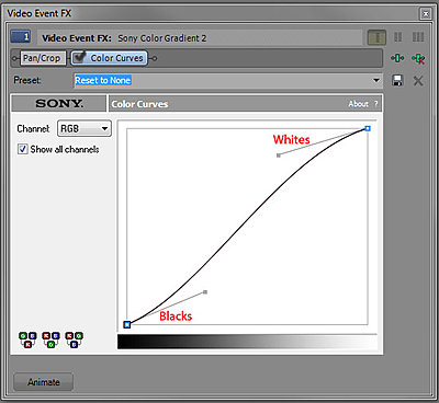

Chris I use "Color Curves" play around with it and you will soon get the hang of it. You can easily control brightness & contrast with curves also add a little extra "Saturation Adjust" to washed out colours.

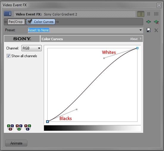

The proper way to adjust brightness and contrast without clipping is using the color curves, Do not move the ends, do not add any new points on the curve, just adjust the two Bezier handles. If you move both handles down (concave curve), you decrease the brightness. If you move both up (convex curve), you increase the brightness. If you move the left handle down and the right one up, you increase the contrast. If you move the left handle down and the right one up, you decrease the contrast. You can play with them, changing their length, and so on. As long as you do not move the endpoints and keep the handles inside the bounding rectangle, you do not clip either end.
As for washed out colors, it is hard to say without actually seeing an example. They can be washed out because of low saturation or because of incorrect exposure or both. Saturation is easy to adjust in Vegas with the color corrector plug-in. Exposure can be adjusted with the color curves.
The two plug-ins can do virtually all CC. Combined additionally with the secondary color corrector, you can do any and all CC with the three of them. But really, most CC can be done with the color curves alone.
