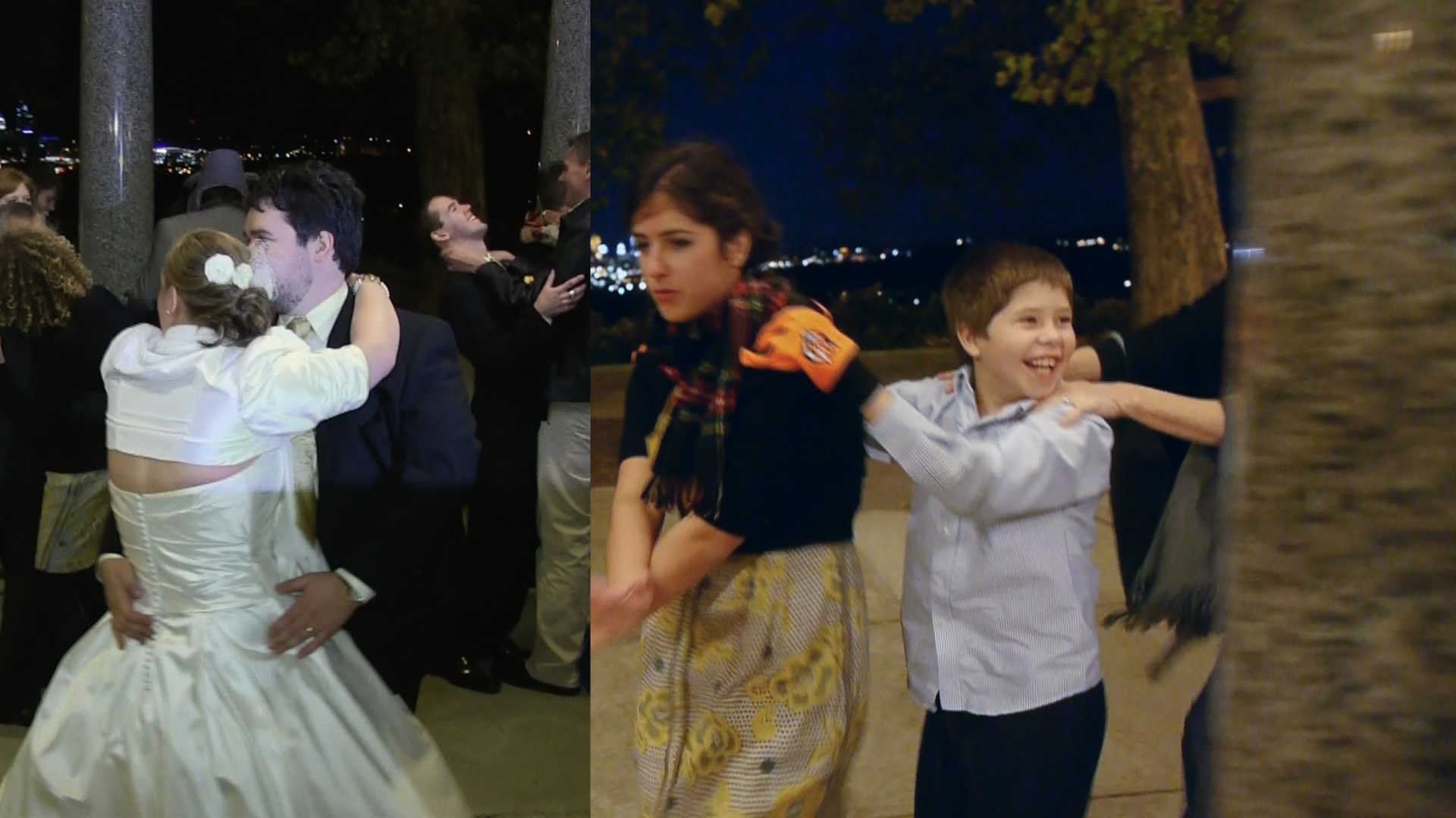

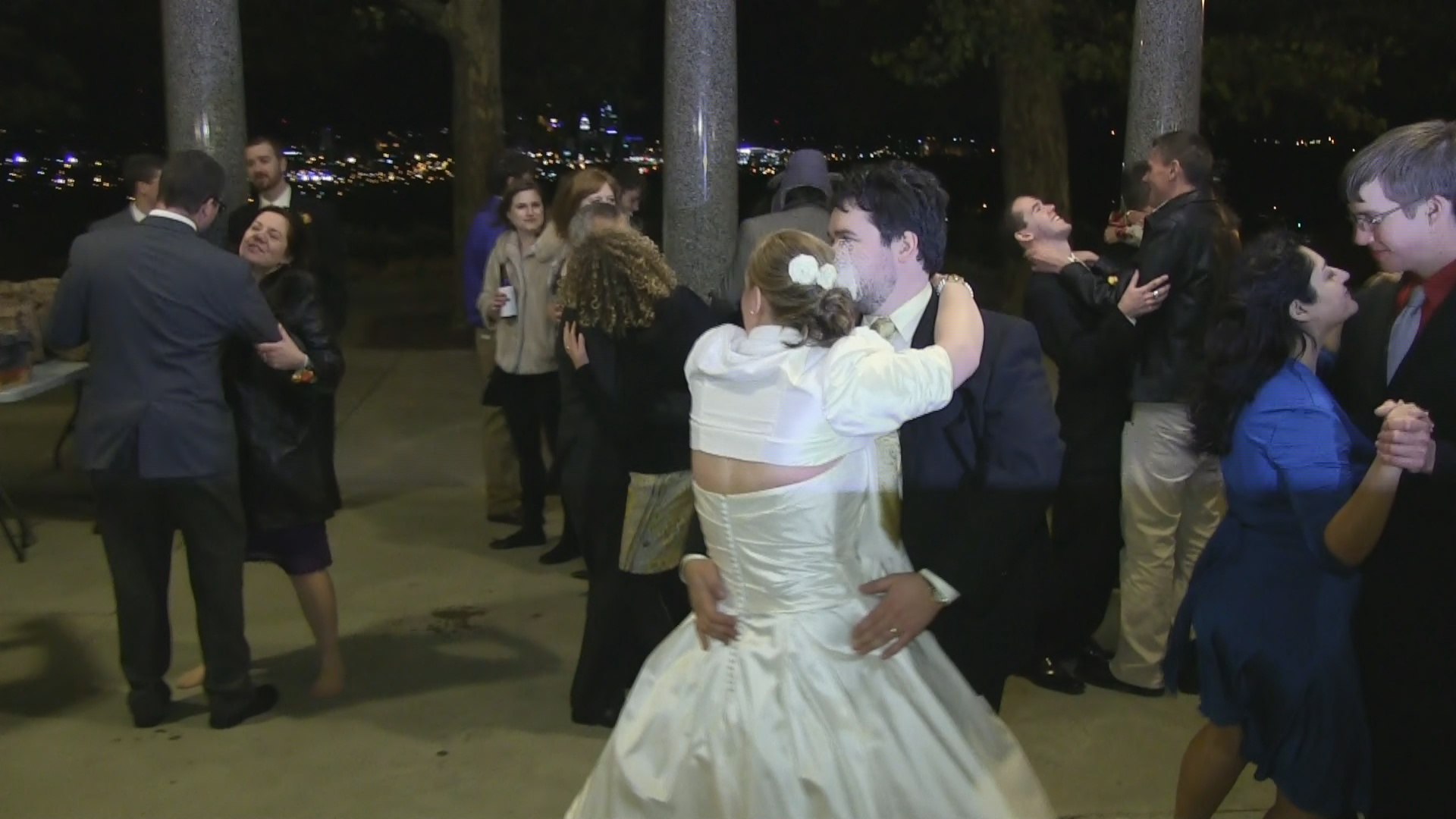

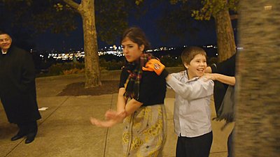

Here are the disgraceful samples. I won't bother trying to explain how and why my white balance was so off, I still am not sure what the hell I was doing, but be that as it may, the images below show the horrid yellowish cast on the "bad" camera. How do I fix this without turning it blue?
I have tried NewBlue Color corrector pro to no avail. I have very limited CC skills, I traditionally use Vegas' secondary color correction to bring things closer, but that's as complicated as I've ever gotten.
I do have HDLink which has First Light, but have never even opened the program, so I'm not sure where to begin with that program, nor do I know if it will help.
Any thoughts?
Second image is how the first one should look. The pillar on the right of the bad image shows just how far off it is when viewed against the pillars in the second image.

This looks alright to me, done in Vegas with 3 way CC.
You could do the same with First Light, its white balance is pretty good.

Gerald, thanks, but you are aware on the extreme right of the bad frame is a pillar that is supposed to be grey with black spots, right? It is blurred, but that is how far off the original image is. The camera WB was so far off. I'm still kicking myself.

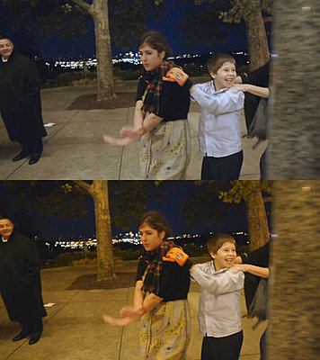

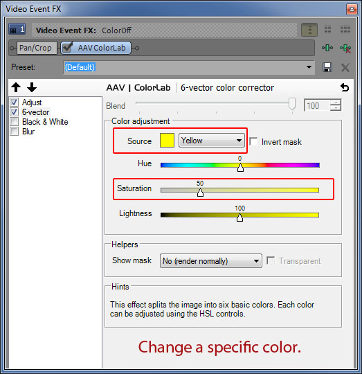

Corrected with AAV ColorLab, I corrected your color accurate one as-well by De-Saturating the Yellows.

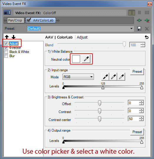

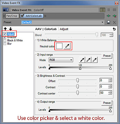

I use AAV ColorLab for most of my color correcting, a brilliant little free plug-in that runs in Vegas. I set WB by using the white cloth that's laying on the floor, it becomes difficult to correct bad WB when you don't have a white source as reference.
Color correction using Vegas and or HDLink-aav-tutorial-1.jpg   Color correction using Vegas and or HDLink-aav-tutorial-2.jpg
