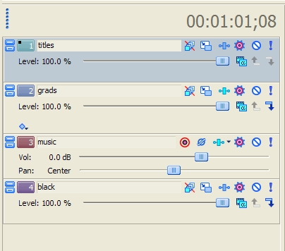

Once you label a track, it stays named until you decide to change it.

However, mine (Veg Pro 9), does not do this ??? I don't get a little white box as shown in your photo. I only get the named track when I hover the mouse over this little box. I tried re-naming etc but it goes away when I remove the pointer. Is there a check box I have missed somewhere ?

I suspect you have extended the timeline area to the left, thereby shrinking the track header area. Try clicking on the vertical bar just to the right of the solo button (!) . The cursor changes to two vertical lines with arrows on either side. Now drag it to the right so that it's just underneath the Help command on the menu bar. Hopefully the little box will become a bigger box and you can type your track titles in.

Brilliant, thanks Ian. That's exactly what's happened. - Voila !! Problem solved.
