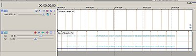

Old November 4th, 2011, 10:33 AM   #9
Location: Windsor, ON Canada
Posts: 2,770
Re: how to use markers on audio and video separately?
Originally Posted by Federico Perale View Post
ok what I meant is to make markers event-specific and grouped with the event itself
Do as Edward suggested and put the markers on the event(s) in the trimmer.
An advantage to doing it this way is that you get to see the markers appear in the timeline event while you're dropping them on in the trimmer.
Remember to click the "Save Markers" icon in the trimmer periodically so you don;t lose any of them.
Here's an example of what this looks like with markers on separate events.
I turned off the track video display and lowered the audio level so that the markers would be easier to see.

thanks Mike/Edward. this seems to be what I was (rather clumsily) trying to explain.
if I do like that will the markers retain their "magnetic" function, to align with other markers etc etc?
The markers are embedded in the event and won't function as expected unless you run the "Promote Media Markers" script that's built into Vegas which turns the embedded ones into full markers..
