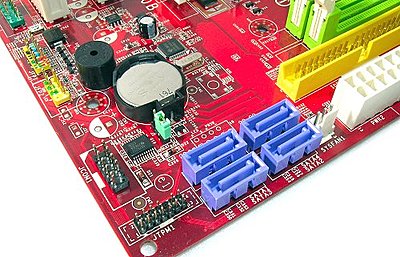

Michael, I don't know if you have done this before but It's really easy to add internal sata drives - when you open the case you will find spare sata-plugs on the motherboard and spare power-plugs on cables coming from the power supply unit. Just plug one sata-cable between drive and motherboard, attach power and you're ready to go.
To initiate the drive you may have to go into Physical Drive manager on Windows7 and format the drive, which is a very simple two click "yes-to-all" operation.
if you are not comfortable with installing drives look at external FireWire RAID units like this one..
