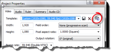

Here's what I'd do (without testing, so maybe some things might have to be "tweaked").
1) Set your Project Properties to 1920x1080 59.94 fps Progressive
2) Right click on your 30p & 60i clips and "Disable Resample"
3) Render to 30p
I think that will work. Pls report back.
...Jerry
Edit: Okay, I just made a test. The key is to make sure you set up your project to match the 59.94 footage. It looks like the "disable resample" is not necessary (although it doesn't hurt).

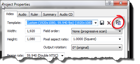

Re: How to render 1080p60 with 1080p30 clips in VP11
Whoops! Looks like we posted at the same time. Again, the key is use "Match Media Settings" to set your project properties to 60p. Then render to 30p (which is accepted by YouTube).
...Jerry

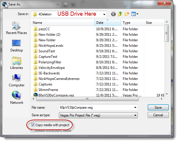

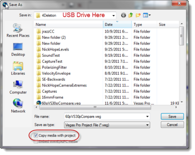

I tried to copy all my subclips out of media project to put them in a flash drive but couldn't figure out how to find them ???
Here's what I'd do... Save As->Copy Media with Project and point that at your USB drive.
...Jerry
Thanks again I was able to find the settings but for some reason I lost the subclips in the media folder when I went to save them in my project on the USB drive. No problem I can redo the subclips later. Good news it plays smooth and I made some DVDs and they played great. Now I'll bring the video to my fathers in the AM my Internet stinks in the sticks and it's a gigabyte to upload to YouTube. In the city it will be quick.

Hi
I think the best option is to set the project properties to the same as your output, or alternatively the same as the majority of your inputs. If you press the film icon top right of the project properties window you can point it at your original video files and it will set the project to match those.
imho (and experience), you're best off if you use the "Match Media Settings" wizard to match your project properties to your source footage. Occasionally, when you need to mix footage on the timeline you can improve your render by right-clicking on the mis-matched video event and "Disable Resample". Rarely, I'll create a small project just to render the oddball clips to the major project media properites (using a high quality intermediate like Avid DNxHD or Sony MXF).
