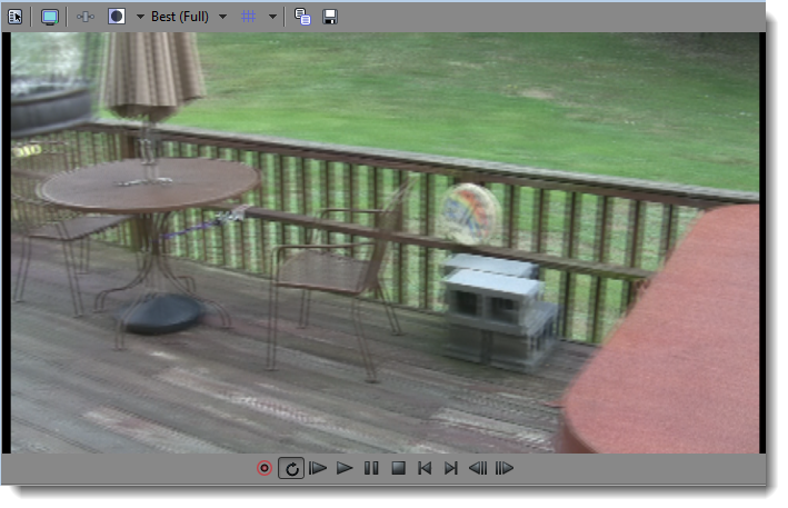

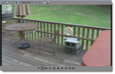

Okay, I did a test - starting with a 1920x1080 60i clip shot with my Canon HG21.
First case: I resized & deinterlaced the clip in HandBrake. Then returned the resized clip to Vegas and re-interlaced to 720x480 60i.
Second case: I resized & deinterlaced the 1080i clip completely in Vegas, making sure the project properties matched the source footage, Video Rendering Quality = Best, and Deinterlace method = Interpolate.
Results of the test are here: CompareHBvsVegas.zip (I would have loved to upload to Vimeo & embed, but it is important that the test be viewed as interlaced video). The "CompareHBvsVegas.mpg" is the comparison video. "BackDeck.mts" is the original footage.
My conclusions:
1) Both methods to a fairly good job of resizing the 1080i source to 720x480 Widescreen with a minimum, if any, artifacts.
2) The HandBrake method displays a minor, but noticable stutter in motion (watch the fence posts).
Is the stutter significant? No, but why go thru the extra steps of HandBrake renders when there actually appears to be a degradation in quality (albeit minor)?
As will all this stuff, YMMV,
...Jerry
btw, For resizing & deinterlacing interlaced footage to progressive for web delivery, I'm a huge proponent of HandBrake.

The strobing on the fence posts with Handbrake is temporal motion from 59.94 going to 29.97 when 2 fields are combined into 1 frame, so I agree it's not the best solution. VirtualDub has a yadif solution by converting 60i to 60p, and lanczos resizing to 720x480 but it's limited in the input formats it accepts. Using Vegas to interpolate fields is far less preferable than than advanced deinterlacing because it loses half the vertical resolution. On the other hand, DVD video itself is a throwback and people demanding it likely have lower expectations of quality.
