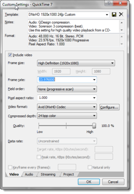

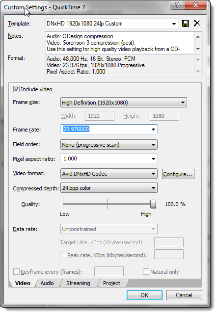

In the DNxHD configuration there is a setting "1080p/23.976 DNxHD 175-8bit" - use that. Then create a custom Quicktime Template that looks like the attached image (i.e. 24.976 progressive).
Of course, when you get to the HandBrake steps, you must, once again use the 23.976 framerate, and, of course, there's now no reason to deinterlace.
