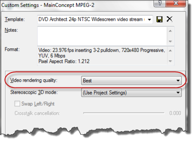

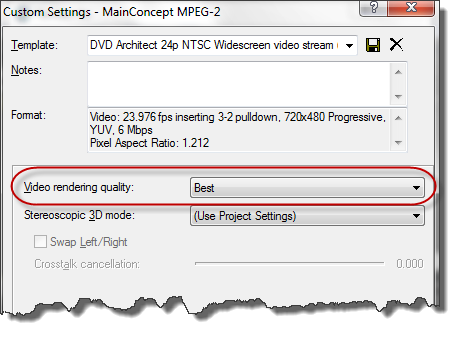

Re: How well does Vegas resize 1080?
It should work fine. Make sure you set your "Video Rendering Quality" to "Best".
...Jerry

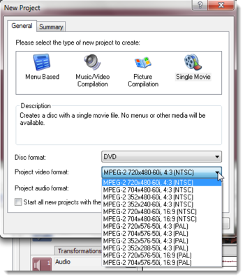

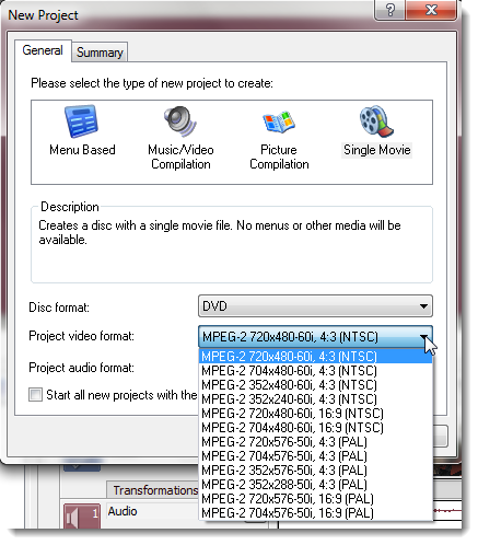

Join Date: Aug 2010
Location: Wilmington, DE
Posts: 129
@David,
How would you do this in DVDA? I can't find the 24p option.
...Jerry
