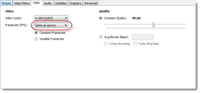

In HandBrake, choose Framerate=Same as Source. That will allow you to render to 60p.
...Jerry
