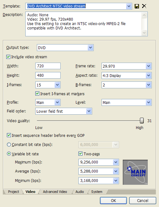

Chris, I use the tried and trusted Mark's DVD bitrate calculator (David, you can find it at http://www.johncline.com/bitcalc110.zip), with two customizations.
Click "Settings" on the main screen, click "1 kilobit = 1000 bits" and (more important) set the "Safety Margin" to 5%.
I've done thousands of DVDs over the years and these settings have never failed me.
For David, here's a screenshot of the custom Vegas settings tab.
Remember to set the "Quality" slider to it's highest setting (i.e. 31).

I rendered the video again today with these settings. Took around 3 1/2 hrs.....now the final doesn't have any audio. Thoughts?
David Mabe is offline   Reply With Quote
Old January 18th, 2012, 09:10 PM   #12
Location: Windsor, ON Canada
Posts: 2,770
Re: Question about best format for DVD - from old VHS
Render your audio using the default Dolby Digital AC-3 Pro template.
Give it the same name as you did your video file and render it to the same folder.
That way, when you load your video file into DVD Architect, the audio will automatically follow.
