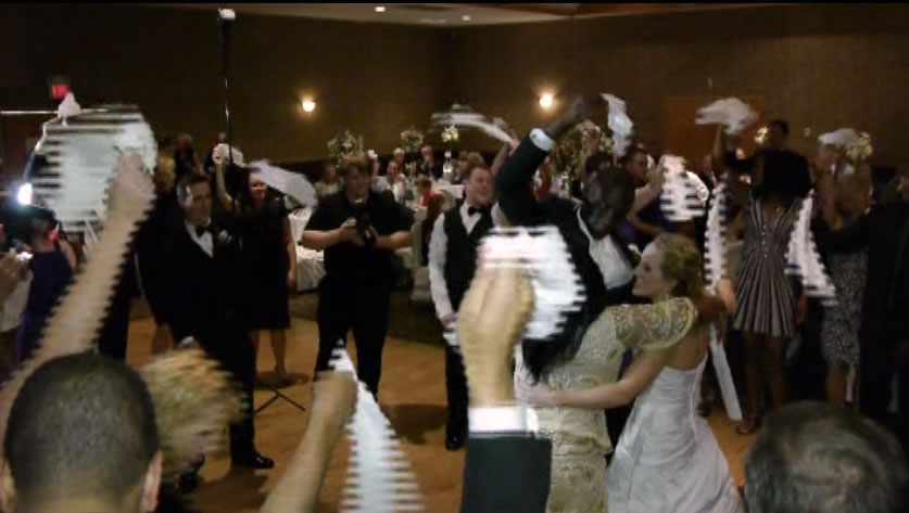

Old April 19th, 2012, 10:37 AM   #4
Location: Cincinnati, OH
Posts: 8,425
Re: Interlacing artifacts or whatever they're called
Here's a good shot of the issue.

Location: Edgewood, NM
Posts: 162
I recognized the problem the moment I saw the jpg. As the other poster mentioned, there is something queer with how Vegas resizes images. My guess would be that it only resizes deinterlaced images - meaning that interlaced material is resized by frames rather than fields which lead to strange looking 'teeth'. This would be something you have little control over - other than to select blended or interpolated deinterlacing, which is necessary even if you are outputting to interlaced form. One option that helps at time is to select the 'reduce interlace flicker' option for the media also.
For thes above reasons, I use the Virtualdub program for resizing material since it canl handle fields individually. It's a bit of a pain to do - and I wouldn't recommend anyone do it with anything other than a lossless codec such as Lagarith to avoid generational errors. I prefer to resize material before editing, because to do it after editing means you need to output the edited material, resize, and then output again in final form. However, if you need to generate final form material in different sizes, you must wait until editing is complete.

Old April 19th, 2012, 10:37 PM   #14
Join Date: Oct 2009
Location: Reno, NV
Posts: 553
Originally Posted by Gene Gajewski View Post
Solutions are out there, they're just not obvious or particularly simple.
While not obvious, all you need to to do is set deinterlacing mode to interpolate frames to properly resize interlaced HD video to interlaced SD video in Vegas. In particular, if you have the deinterlacing mode set to none in the preferences then Vegas makes a mess of the scaling as depicted in the screenshot above.
